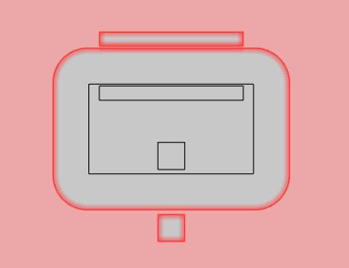

Good evening,
I am running a simple 2d model of a single phase transformer. I am imposing a current at the primary and I want to obtain the induced current in the secondary. How can I couple the two sections of the secondary coil in which obviously the induced current is the same (on one side going into the plane and on the other side going out of the plane)? For now I can only see current in the section inside the core.
Thank you, Enrico

First of all, there may be some challenges to accomplishing your objectives using a 2D, rather than a 3D model. A simple 2D model imposes infinite translational symmetry in the direction perpendicular to the plane. Sanity check: Does your mental picture of the transformer extend to infinity in that direction? I encourage you to post your .mph file to the forum so that others can examine it and offer their suggestions.
