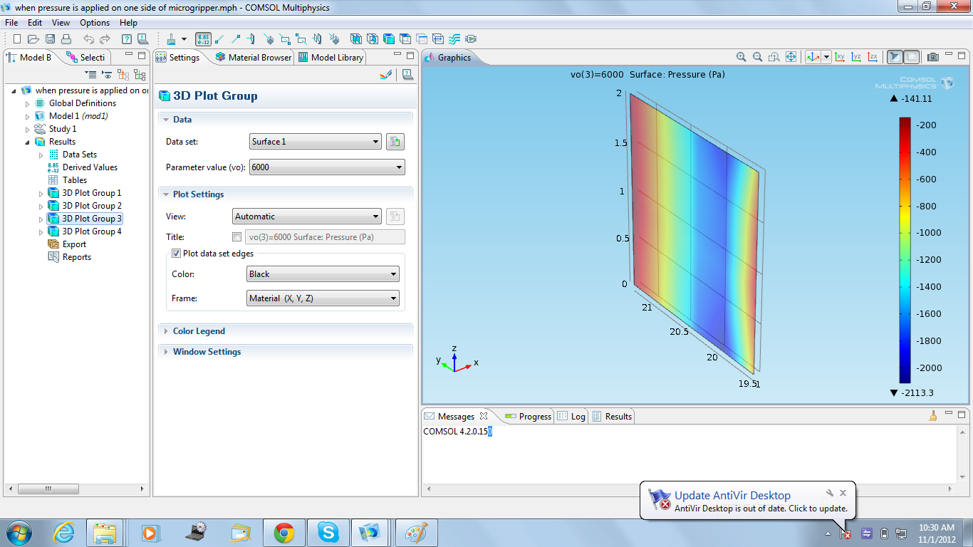

                                                    Thanks Edgar
one more thing..I would like to ask is that why do pressure values are coming negative in the vertical bar on the right side.
(snapshot attached)
                            Thanks Edgar
(snapshot attached)

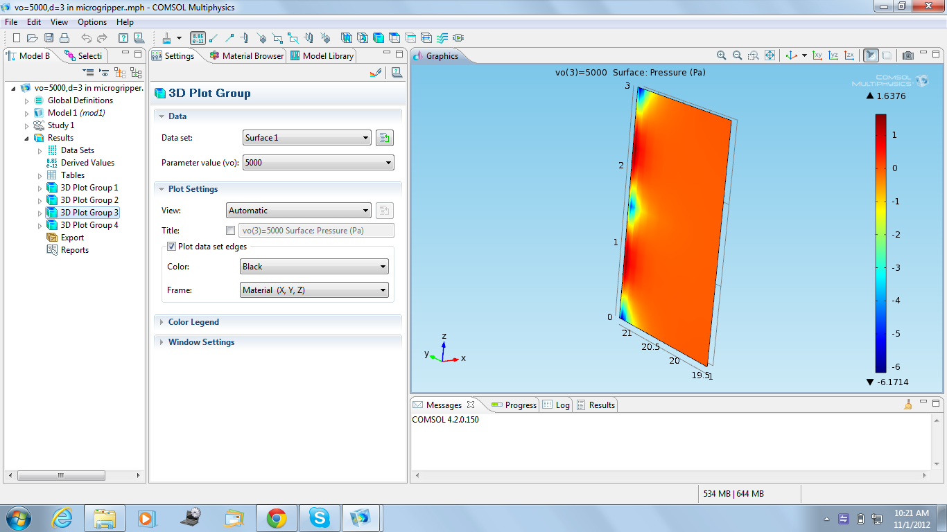

on your fist graph it looks like you have a rather coarse mesh, perhaps too coarse, on the second I suppose that the sign comes from the surface definition, pressure is defined to the external surface normal. Could that be involved ?
