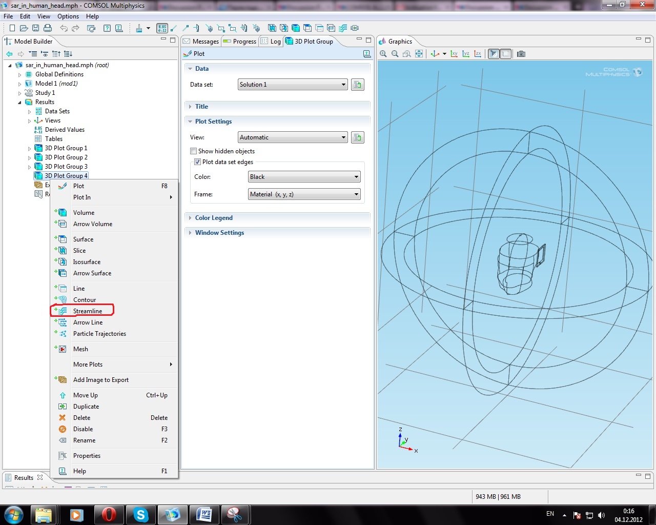

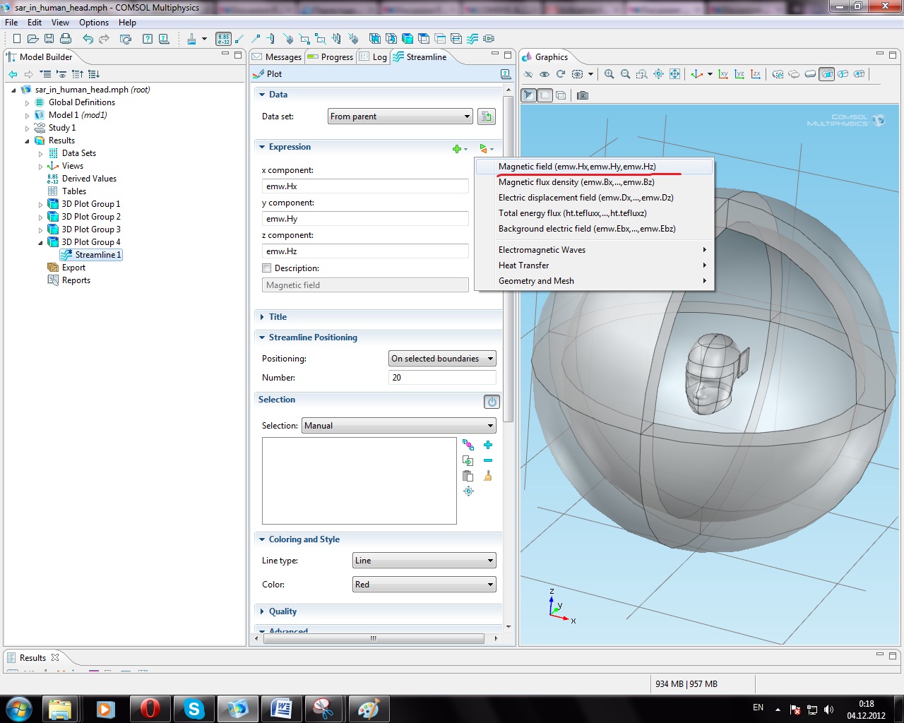

Dima,
Use the following steps to create magnetic stream lines:
1. Results>3D Plot Group
2. 3D Plot Group 1>Streamline
3. In the expression to plot, define Magnetic flux density vector {Bx,By,Bz}, or Magnetic field vector {Hx,Hy,Hz}
4. In the Streamline Positioning section, adjust streamline parameters to get nice plot for magnetic field lines
Good luck,
Sergei Yushanov

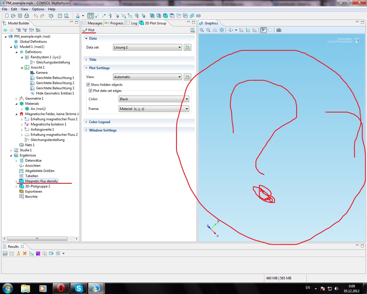

Thank you!
But I've done it before. And the result was not granted me.
Maybe I'm doing something wrong?
Thank you! But I've done it before. And the result was not granted me. Maybe I'm doing something wrong?

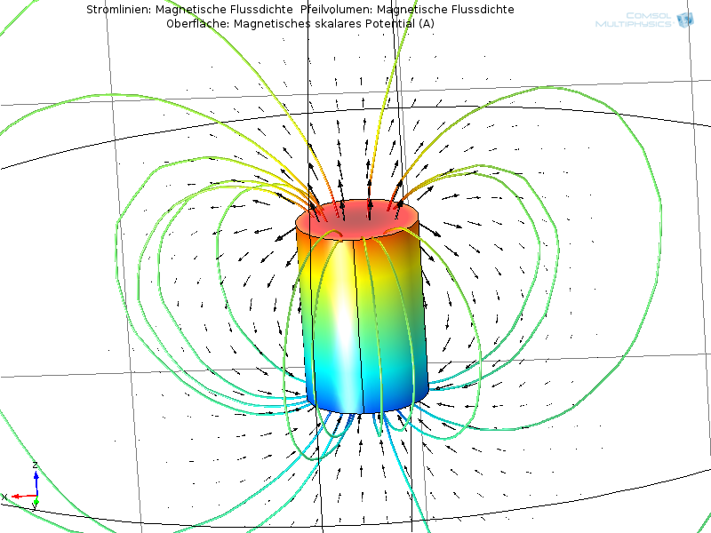

Hi!
Something like this? You can play a lot with 3D plots ;-)
Ralf
Hi! Something like this? You can play a lot with 3D plots ;-) Ralf

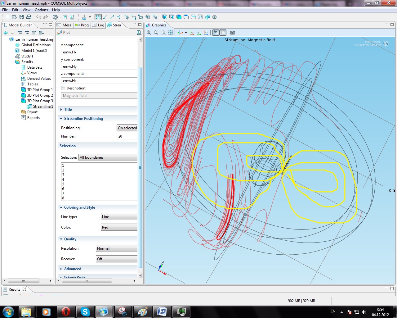

Hi!
Yes I want that! But somehow nothing is drawn. =(
In the graphics tab - empty!
[QUOTE] Hi! Something like this? You can play a lot with 3D plots ;-) Ralf [/QUOTE] Hi! Yes I want that! But somehow nothing is drawn. =( In the graphics tab - empty!
Posted: 1 decade ago 2012/12/05 15:33 JST
check the sub nodes of your plot, something is not set-up correctly, or you are not pointing to the right data set, there can be many things.
Have you gone through the doc to understand what the different tab and entries do ? usually the most important are coming first (on the top)
Hi check the sub nodes of your plot, something is not set-up correctly, or you are not pointing to the right data set, there can be many things. Have you gone through the doc to understand what the different tab and entries do ? usually the most important are coming first (on the top) -- Good luck Ivar
