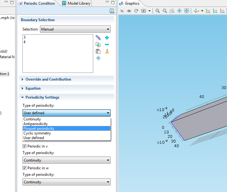

Try setting the type of periodicity in the periodic BC to “Floquet Periodicity”.

Hi Nagi,
thanks for your quick reply. Unfortunately, there is no such option in the 'periodicity type' menu. I can only choose between 'continuity' and 'antiperiodicity'.

Make sure you’re looking at the top “Type of periodicity” tab (see attachment). If you still don’t see the Floquet Periodicity option then you may be using an older COMSOL version. I believe this feature was introduced in v4.3.
