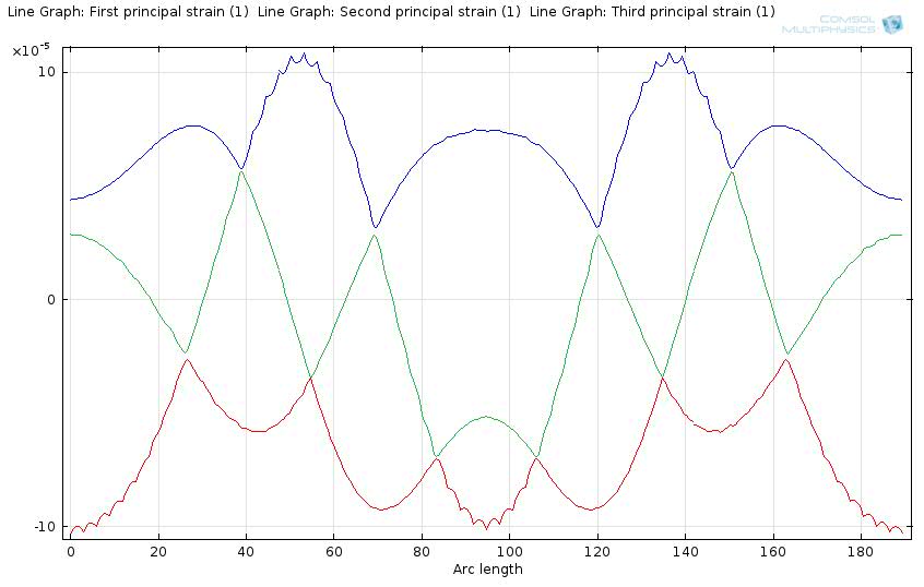

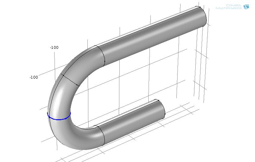

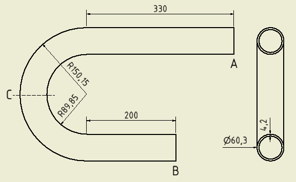

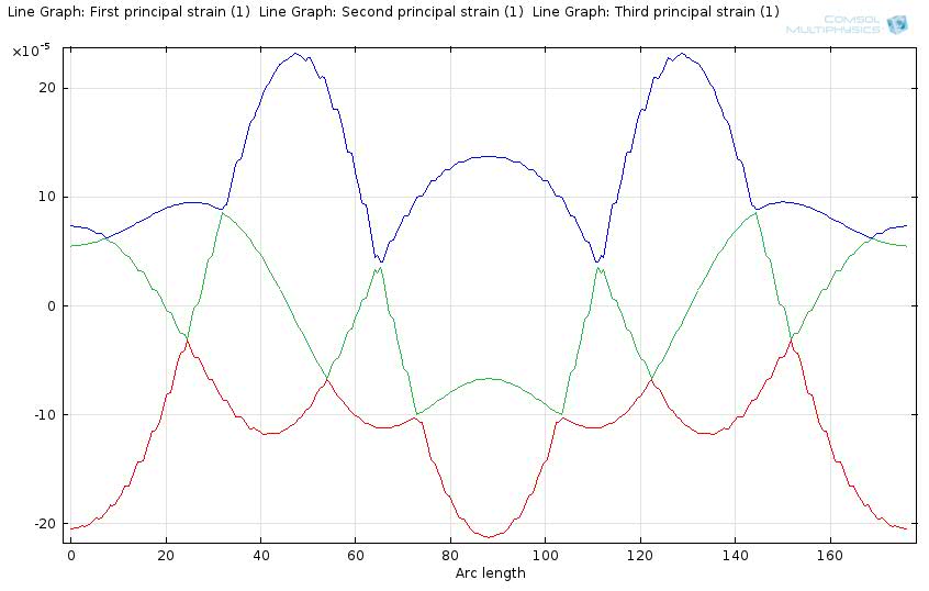

The parameter of the bend pipe, Position for analysis and line graphs for principal strains are uploaded as Attachment. In my Simulation, the pipe is loaded by 300N downwards on cross section A (see photos), cross section B is fixed. The material is structural steel. The position for plotting graph is an outside circle on bend pipe (position C in photo). There are two photos show the principal strains from shell element and solid mechanics. That's obvious to observe the big difference between two graphs.The results of principal strains by shell element are one time larger than meshed by solid mechanics.
