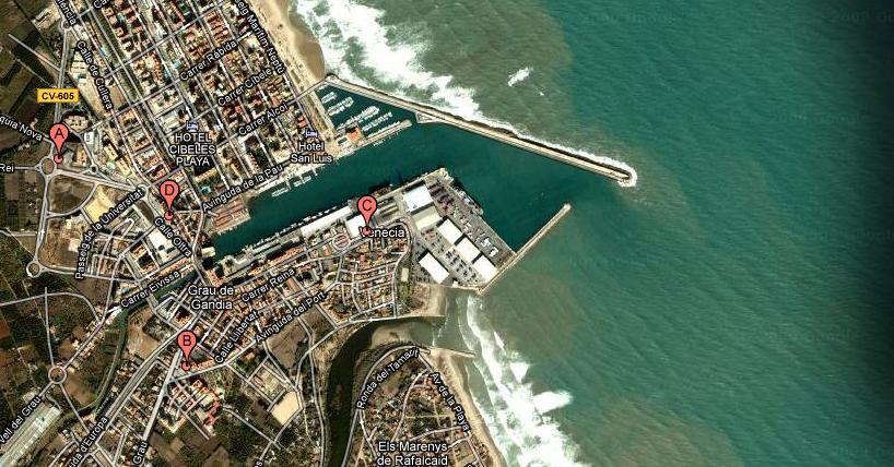

i'm Irene from Italy and i'm doing my final work for the thesis in engineering.
I'm using 'fluid dynamic' of COMSOL MULTIPHYSICS 3.5.
I need to find the sea velocity field in an area of 3 km that includes the port of Gandia(a spanish city) .
I did the draw in comsol; in 'subdomain setting' i included only dencity=1000 and dynamic viscosity=0.001,
in 'inlet' i included only pressure(t)=111125.
In 'boundary condition' i chose for sea side 'open boundary -no viscous stress'; to simulate the port and the coast i chose 'wall no slip'; for the entry of port i chose 'inlet-velocity 0.1'; near the port there is a river so as boundary condition for that one i chose 'inlet -velocity=1'
the quality of meshes looks good.

Now for your BC, as you describe them, one thing strikes me (or my sens of physics). You talk about a closed area for the port with one inlet and one outlet, and two given velocities. As its at sea level I assume you have also some gravity and you do not expect to see the sea level in the port go under that of the free-sea or ?
So if you define a constant speed on the outlet, for a given speed at the inlet, assuming that the inlet /outlet sections remains the same (up to the sea hight level) you might be overconstraining your problem here, which makes the solver having some difficulties to find a valid solution.

i tried to change my boundary condition, but i have always the same error, i did't try to change solver because i could read that 'direct solver' ,that is the one that i used for stationary analysis,looks good,but i'm not sure of that; it's a little bit difficult for me to explain whell my problem with an e-mail becouse of my bad english,so i'll send you my model with real geometry ( in which you can see the river and the port) and a simple geometry in which i tried to use the same boundary condition for to see if was the geometry the problem but is not so,i think!.the scripts are in comsol 3.5.
These project is just a test, so for now there aren't real values of currents and it not includ wind stress...etc.

I would even have used, as outlet boundary a half a circle to get a constant radius from the port outlet but that perhps more an esteatical issue (simpler though you have only 1 "sea boundary).

By the way looking at the streamlines and the difference of flow from the two rivers, I suspect that you have a Venturi effect from the higher external river flow going along the port outlet, a nice study there (you should add some tide flow and sea streaming too, no ?)
