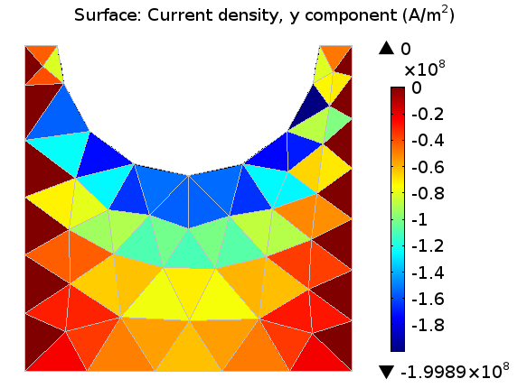

Hello there,
I am quite new in using and COMSOL and I was wondering why - when displaying a component of the current density - each element (tetrahedron) is displayed not with a single color but rather with a colored gradient even if smoothing is turned off. As far as I understand quantities such as the current density should be defined for an individual element rather than its belonging nodal points. If this is correct then how can I assign just one value (color) to this element?
Thanks in advance,
Kristoffer

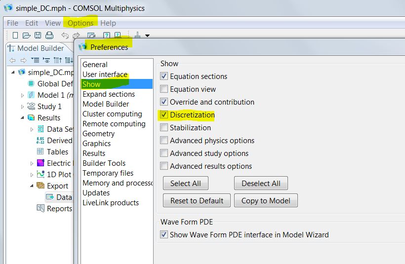

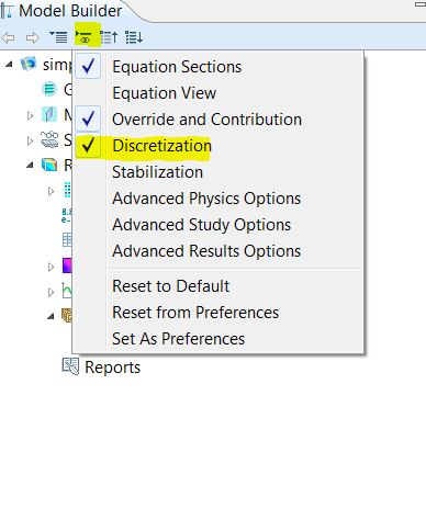

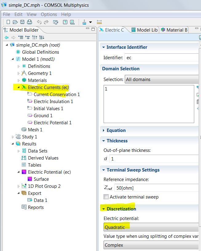

there are two ways to switch on the display of Discretization screen1.jpg OR screen2.jpg should be enough to allow you the settings as displayed in screen3.jpg
Sven
Hi Kristoffer, there are two ways to switch on the display of Discretization screen1.jpg OR screen2.jpg should be enough to allow you the settings as displayed in screen3.jpg Sven
Posted: 1 decade ago 2013/10/08 23:38 JST
I tried both versions (screen1.jpg and screen2.jpg). Unfortunately this does't result in screen3.jpg (except for setting up a new simulation).
