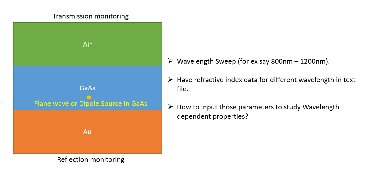

I m a beginner in COMSOL. My structure is shown in picture. Its is Au-GaAs-Air structure from bottom to top (2D). Simply I can brief out my objectives in following steps.
1) Have refractive index with respect to each wavelength in text file.
2) How to input those parameters?
3) How to do Wavelength sweep? for ex between 800nm-1200nm.
It would be really helpful if anybody could help me.

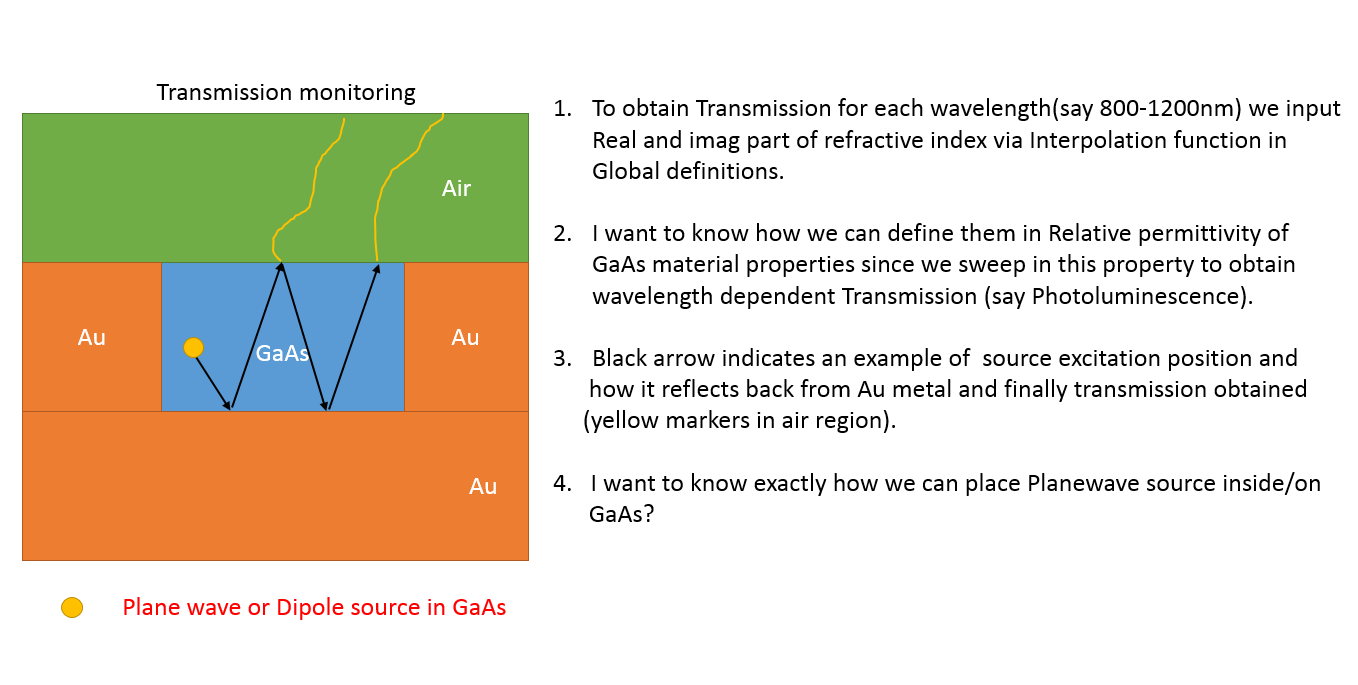

Actually for understanding I said as real and img. But actually Imported real part (n) of GaAs as txt file and named it as reGaAs and similarly imaginary part as imgGaAs. I think this naming will be no problem. I imported this txt file by right clicking Global definitions and from there Functions-Interpolation.
(For clear visual of structure check the attachment. I made few changes in structure design and kindly find in attachments.)
Generally I simplify my Simulation idea as you refer my Au-GaAs-Air structure:
1) To obtain Transmission for each wavelength(say 800-1200nm) we input Real(reGaAs) and imag (imgGaAs) part of relative permittivity (obtained from refractive index real and imag parts) via Interpolation function in Global definitions.
2) I want to know how we can define them in Relative permittivity of GaAs material properties since we sweep in this property to obtain wavelength dependent Transmission (say Photoluminescence). In my case since relative permittivity is = reGaAs(lambda) - j*imgGaAs(lambda). But I think I have some error here.
3) Black arrow indicates an example of source excitation position and how it reflects back from Au metal and finally transmission obtained (yellow markers in air region).
4) I want to know exactly how we can place Planewave source inside/on GaAs?
HI Maha Thanks for your reply. Actually for understanding I said as real and img. But actually Imported real part (n) of GaAs as txt file and named it as reGaAs and similarly imaginary part as imgGaAs. I think this naming will be no problem. I imported this txt file by right clicking Global definitions and from there Functions-Interpolation. (For clear visual of structure check the attachment. I made few changes in structure design and kindly find in attachments.) Generally I simplify my Simulation idea as you refer my Au-GaAs-Air structure: 1) To obtain Transmission for each wavelength(say 800-1200nm) we input Real(reGaAs) and imag (imgGaAs) part of relative permittivity (obtained from refractive index real and imag parts) via Interpolation function in Global definitions. 2) I want to know how we can define them in Relative permittivity of GaAs material properties since we sweep in this property to obtain wavelength dependent Transmission (say Photoluminescence). In my case since relative permittivity is = reGaAs(lambda) - j*imgGaAs(lambda). But I think I have some error here. 3) Black arrow indicates an example of source excitation position and how it reflects back from Au metal and finally transmission obtained (yellow markers in air region). 4) I want to know exactly how we can place Planewave source inside/on GaAs?

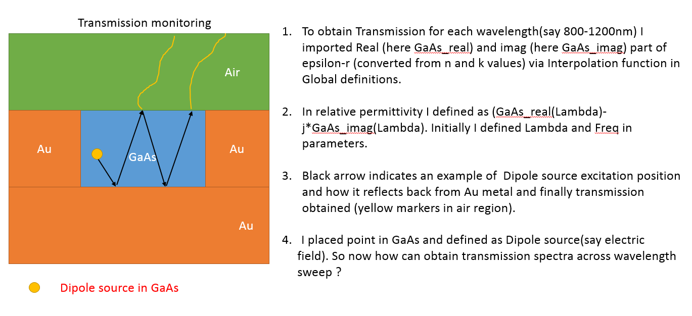

(I had attached the concept of my simulation as picture where you can understand my idea)
My Goal is to get PL spectra (may be Transmission ) vs wavelength. I had placed Point in GaAs and used that as Dipole source. My target is to achieve Transmission spectra coming out from GaAs vs wavelength (say 800-1200nm). I m really confused here how-to-do. For obtaining transmission spectra do I need to use port condition or what ?
Hi Maha Actually Now I had imported Refractive index values via interpolation. I had converted n and k values to Relative permitivity say GaAs_real and GaAs_imag. And also now I m trying to use Dipole source which is useful for my research work. Previously in Parameters I had defined Lambda = 1000 and frequency = c_const/Lambda[nm]. I had used nm in Lambda since imported (ex. GaAs_real) wavelength values as say 800 ..... without nm. In GaAs Material properties I had defined Relative permittivity as = GaAs_real(Lambda)-j*GaAs_imag(Lambda). I think this is correct definition. So In Parametric sweep now I can do Lambda dependent. (I had attached the concept of my simulation as picture where you can understand my idea) My Goal is to get PL spectra (may be Transmission ) vs wavelength. I had placed Point in GaAs and used that as Dipole source. My target is to achieve Transmission spectra coming out from GaAs vs wavelength (say 800-1200nm). I m really confused here how-to-do. For obtaining transmission spectra do I need to use port condition or what ?
