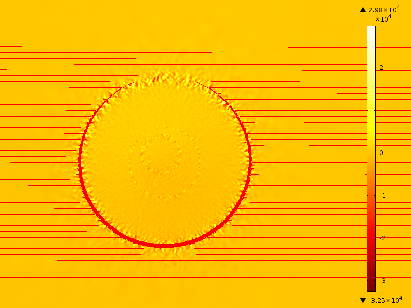

in fluid flow simulations with a moving wall boundary condition (a rotation of a circular surface region), I get strong pressure oscillations at the edge of the rotating part of the surface (where the rotating part is in contact with the non-rotating part), that even do not disappear for higher mesh densities. Nevertheless, the velocity distribution seems okay.
Can anyone please comment on that effect?

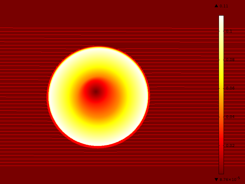

Hello Luke,
thanks for your comment. In my case, the non-rotating part is subjected to a symmetry condition (u dot n = 0), so that should be fine. Probably, the high velocity gradients (see attached) cause the fluctuating pressure distribution (also attached). Changing the mesh does not change anything qualitatively, but in pressure quantities.
The question arises if I can trust in the velocities?
Marcel

Marcel,
I can't make out what you're doing in the model from the pictures, but the pressure distribution certainly appears to be erroneous, so I would not trust any of the results. Something in the model setup is generating this non-physical behavior. From the pictures, it appears that you may have fluid on both sides of a moving wall boundary. If so, this may be contributing to the strange pressure results.
Luke Gritter
AltaSim Technologies

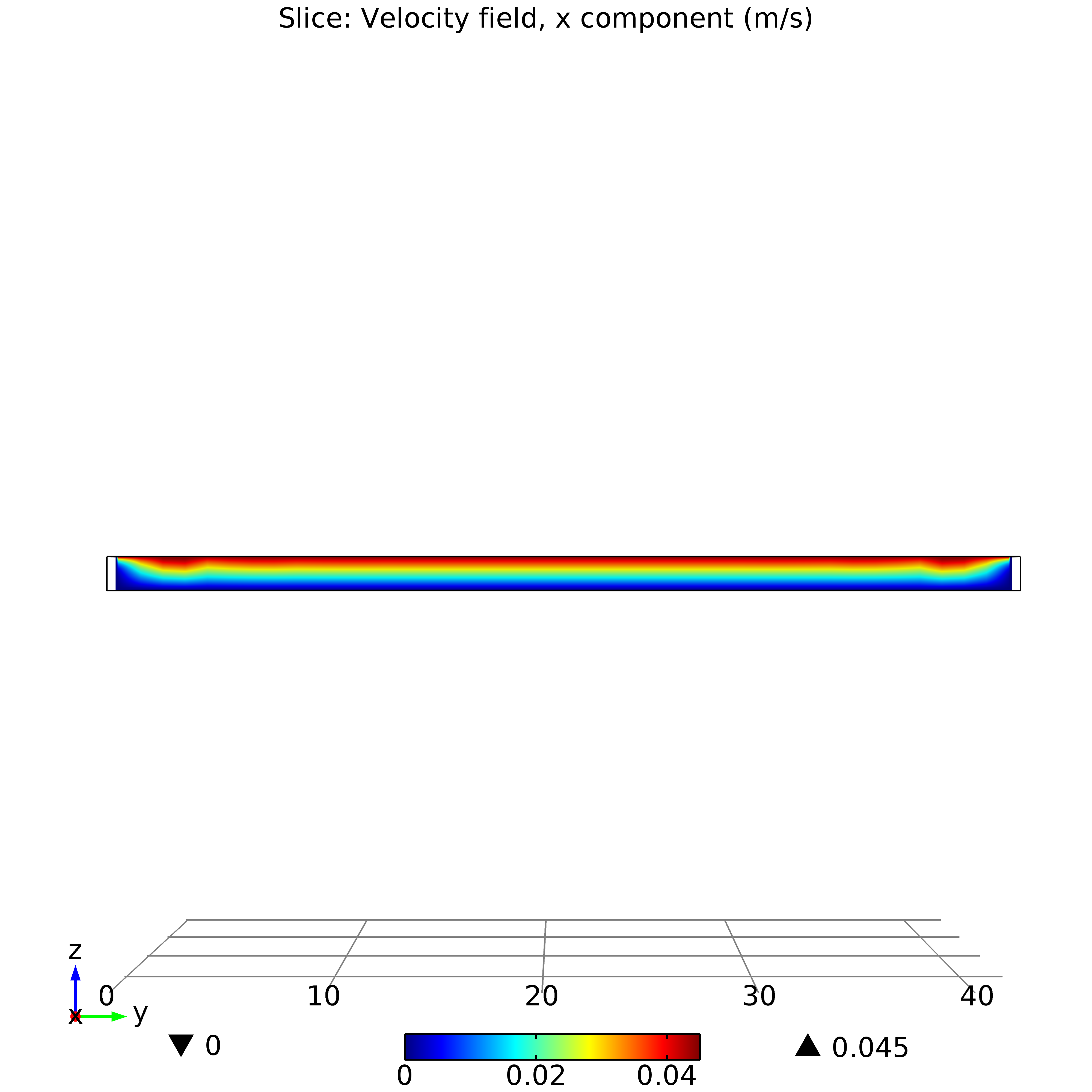

Hey Luke,
Thank you very much. I included a slip boundary between the no slip wall and the velocity wall (not an interior wall, but next to the moving wall, on the surface). Is that what you meant? Now I get the right maximum value of the velocity, but the distribution close to the no slip does not seem correct. You can find a screenshot attached.
Do you know why that happens?
Thanks
Sabine
Hey Luke, Thank you very much. I included a slip boundary between the no slip wall and the velocity wall (not an interior wall, but next to the moving wall, on the surface). Is that what you meant? Now I get the right maximum value of the velocity, but the distribution close to the no slip does not seem correct. You can find a screenshot attached. Do you know why that happens? Thanks Sabine

Sabine,
It is difficult to discern what is going on from the picture. If you can post the model file, I will take a look at it.

Posted: 1 decade ago 2014/03/26 4:03 JST
I think I figured it out now. My slip-boundary was too small (<0.1mm) and my mesh was too coarse.
Thank you very much for your help
