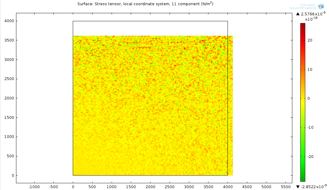

Changing to plane stress works for the strains. However, the x-stress result is still wrong. In theory, it should be x-strain multiply by E, which should yield about 9000Pa, but the result i'm getting is 4e-10, which is weird. Also the values fluctuates and there is no smooth data. Could this be a resolution problem? Please advise. Thanks.

Theoretically, Sigma_xx should be exactly zero. COMSOL returns a value of the order of 10^-10 because of finite numerical accuracy. In other words, the Sigma_xx plot shows you numerical noise. Your mesh is actually much finer than really needed for this application.
Please check out this link for the relation between stresses and strains in plane stress: http://en.wikipedia.org/wiki/Hooke%27s_law#Plane_stress . Theoretically, Sigma_xx should be exactly zero. COMSOL returns a value of the order of 10^-10 because of finite numerical accuracy. In other words, the Sigma_xx plot shows you numerical noise. Your mesh is actually much finer than really needed for this application. Jeff

I'm a little confused. I agree with the z-stress (sigma33) to be zero which is the case in the sim. and also the link that you provided. However, x-stress should not be zero (sigma11), which is what is stated in the link too. Also, given that I have a proper value for x-strain (non zero), it should be inferred that x-stress cannot be zero too. Please advise on this.

If you compute the expression at the link above you will find that it results in Sigma_xx=0. This is also trivial if you think about it: your model is invariant in the x direction so if you imagine taking a vertical cut in that part there cannot be any net force exerted by one side onto the other.
If you compute the expression at the link above you will find that it results in Sigma_xx=0. This is also trivial if you think about it: your model is invariant in the x direction so if you imagine taking a vertical cut in that part there cannot be any net force exerted by one side onto the other. Jeff
