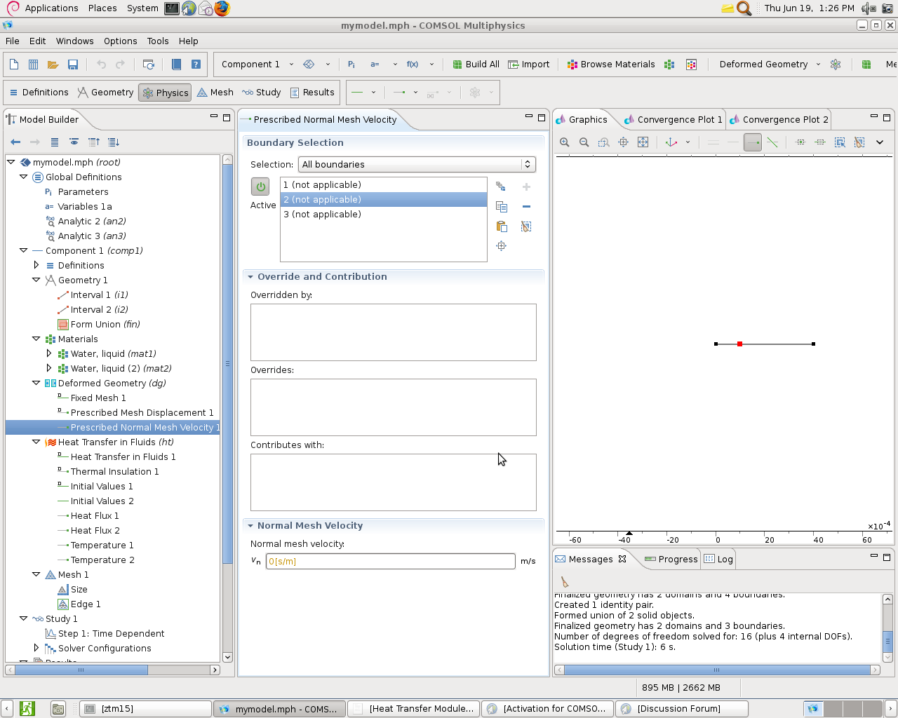

I am trying to model a 1D Stefan problem ..
I have created 2 consecutive intervals as 2 domains and the boundary is the meeting point of both intervals ..
In order to model it as a moving boundary phase change problem , I want to give normal velocity to the boundary (from the Stefan condition) ...
But by using deformed geometry I am unable the choose the boundary in the prescribed normal mesh velocity section ...
Can anyone help ?
I have attached the screenshot herewith
Thanks in advance
