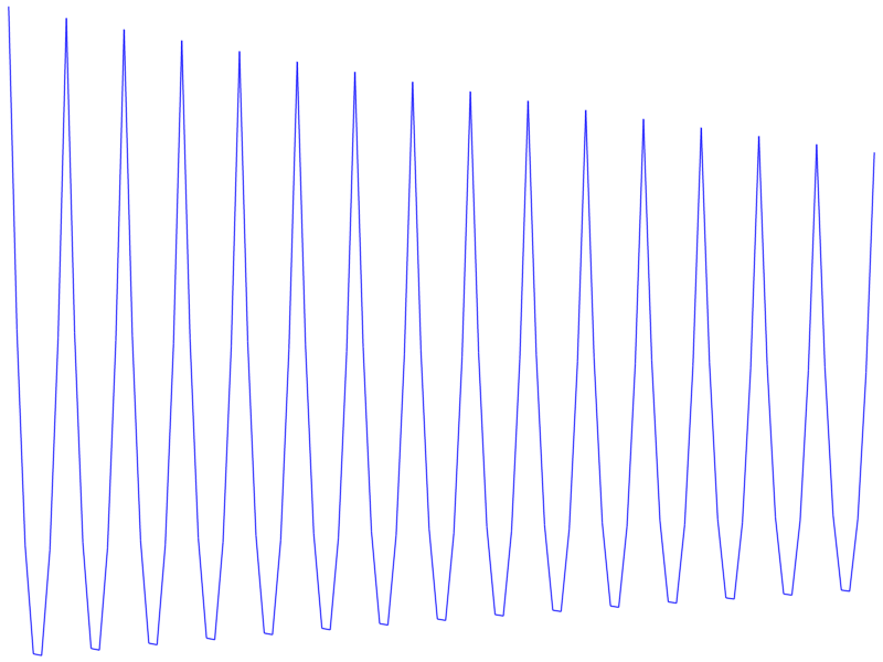

how many boundary condition should be imposed on spatially first order differential equation in comsol?
I'd like to solve a 1st order differential equation like this in 1d domain:
du/dx =u
x in [0,2]
u(0) = 1000
while I was using the General Form PDE in stationary , there are two boundary point in x=0 and x=2.
the default condition is zero flux condition at both ends. However, for a 1st order equation there should be only one boundary condition. zero flux at x = 2 is over-determinant for this problem.
The results obtained is also oscillating as shown in the attachment.
So, my question is: what condition should I impose at x=2? for this kind of equation?

Your question is more like calculus than FEM problem. Of course you are right, the solution is in closed form
u(x) = 1000*exp(x)
and boundary condition u(2) is overkilling. But if the problem were
du/dx = k*u
the solution would be
u(x) = 1000*exp(k*x)
and, e.g., a boundary condition u(2) = b would require that k =½*ln(b/1000); zero flux condition is not possible, neither u(2) = 0.

So, If the ODE is very complex, what B.C. should I impose at x=2?

Posted: 1 decade ago 2015/02/05 12:34 JST
I mean mathematically, I cannot solve a 1st order ODE with two BCs. right? But in comsol, I cannot just set one BC during setting the problem. If I do not set BC at x = x_end, the system will impose a default BC for me. This will cause a mathematical fallacy. And the result is also wrong.
Your previous solution is to solve the ODE first, and set the BC at another end using the correct value. I think it is a kind of cheating, right? If I can solve the ODE, why I have to set the BC?

Posted: 1 decade ago 2015/02/06 17:19 JST
It is a simple quasi-1d compressible flow equation of motion with known pressure distribution and friction factor
u: velocity of gas, unknown
cf: 0.003, Darcy friction factor
qm: mass flow rate, qm(x) is known
A: area, A(x) is measured
Cw: wetting perimeter, Cw(x) is known
x: axial distance. 0<=x<=2
p: pressure, p(x) is measured
du/dx = -A/qm*(dp/dx) - cf*u/2/A*Cw - u/qm*(dqm/dx)
u(0) = u0
This is the equation I need to solve. What is the BC at x=2?
I do not have second BC for my problem, I did not set the second BC either. But the comsol set it for me automatically.
It seems that comsol cannot be used to solve IVP in 1d space.

Posted: 1 decade ago 2015/02/07 16:56 JST
I think they are the same problem. du/dx = f(u,x;p), p is given parameters including spline coeff.s to fit with experiment data, which is pre-defined before ODE solver runs. It does not matter whether the coeff.s are constants or varies with x. I used python odeint in scipy to solve this. constant friction coeff. is not a problem.
I think the problem is the default behavior of comsol. It impose a default B.C. for 1d-ODE at unspecified end, which make the equation over-determined. I do not know what happend next, but I can still produce a result to meet the over-determined ode.
The general form of PDE in comsol includes d^2u/dx^2 terms, which means it is designed to solve 2nd PDE. I think comsol should have some limit on the coeff. of general form of PDE, or illegal BC will cause misleading and confusing results.
