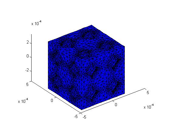

I'm using the model of Tetrakaidecahedron to compute the acoustical behaviours of foam. Everything goes well with just one cell. The process is like:
g1 % tetrak cell
g2 = block3(dimx,dimy,dimz,'base','corner','pos',{xmin ymin zmin}, ...
'axis',{'0','0','1'},'rot','0'); % the cube that contains the tetrak cell
g3=geomcomp({g1,g2},'ns',{'CO1','BLK1'},'sf','BLK1-CO1','repairtol', ...
1.0E-4,'face','none','edge','all'); % the fluid phase on which the calculation is executed
But when i include more than one cell in the computation. Let's say i would calculate on a cube of 2x2x2 cells using some operators like mirror or move to split the original cell g3. It doesn't work even the Meshextend processing is done. An error message appears
fem.elemcpl{1}.map{1}.dv must be a cell array of strings
??? Error using ==> fem2jxfem at 50
Errors found in FEM structure.
Error in ==> multiphysics at 81
jxfem=fem2jxfem(fem,femname(inputname(1),fem),{'lib'},false,false);
Error in ==> testmainfunction at 760
fem=multiphysics(fem);
I have no idea this is due to the overlapping elements by mirror/move or other errors. If anyone experienced the same computing problem, i appreciate your advices.
(the attached image below is the meshing process where my codes end)
Thanks in advance,
TRINH
