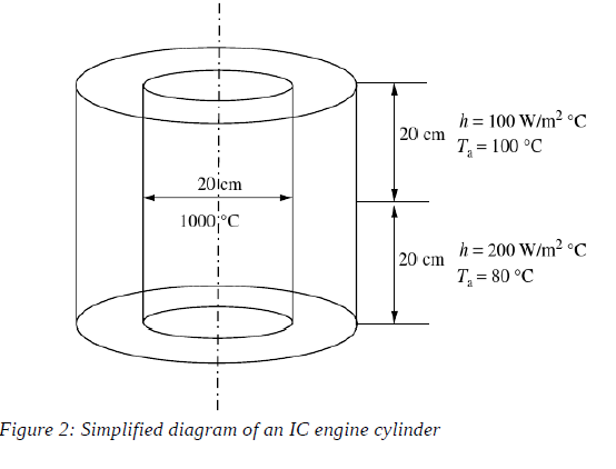

As the title says. My temperature varies only on the scale of a few Kelvins, but still I get a engineering strain of more than 1. I am trying to model an IC engine cylinder made out of cast iron for a school project. The temperature inside varies as a periodic function of time, resembling the movement and ignition of piston and fuel. I have made some considerations for the boundary conditions and symmetry which are included in the pdf file in section 2. I have also included the mph file itself and a diagram of the problem in 3D.
