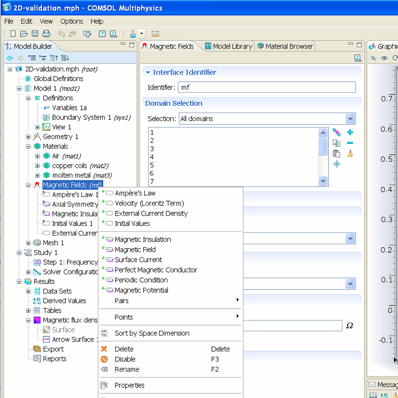

You are right, it is domain feature. But I cannot see "coil domain" after right-click on magnetic field in Model Builder, as shown in attached picture.
Dear Edgar, You are right, it is domain feature. But I cannot see "coil domain" after right-click on magnetic field in Model Builder, as shown in attached picture.

Yes there are many options missing. I have no idea why. Is this really version 4.3? You may have to ask the COMSOL support.
