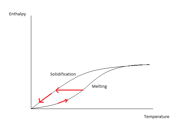

Thanks for your answer.
For my issue the model of comsol isn´t sufficient because melting and solidification is there modeled as "the same just with other sign". But my material has reasonable differences between melting and solidifcation, meaning the curves for the enthalpy over Temperature look very different for melting and solidification. I attached a very simplyfied Picture for better understanding.
In my enthalpy based method the heat equations is the following:
(dH/dt)*rho=(d/dx)(k(dT/dx)
With Values out of DSC for H
For a normal melting i get with my in equation model self written enthalpy based method nearly the same results as the comsol model. And a whole cycle is no Problem too. My only provlem is to teach comsol to use the in my Picture marked red path. This should simulate solidification when the material isnt´t already completely solid.
If i would say use the the solidification curve if gradT is negative in this case, i would put Kind of energy in the System whithout physical reason. Thats why i want to follow the red curve. But i cant imagine how to do that with comsol.

Well my model is in 3D you can also replace the d/dx by an Nabla Operator just didnt´t mangaged to get the Symbol in the Forum so i made a 1D out of it ;-)
The Material is a PCM material, a Compound of some paraffine, binder and a material to improve thermal conductivity. I allready researched something about modeling such incomplete melt-solidification cycles and there are validated models in literature which tell you not to follow the same curve back but the red path shown in my attaced Picture from above.

Posted: 1 decade ago 2015/09/29 10:11 GMT-4
The problem is that you have 2 different temperatures for the same H(T) value,
Just an idea; is it possible to write the function T(H) and swith at the same temperature between melting of solidification curves? ...

Posted: 1 decade ago 2015/09/29 11:00 GMT-4
I think every time i do a sudden switch from one to another curve is either not physically correct or makes numerical Problems. Another thing is that temperature is my dependent variable so enthalpy will not Change with time without a temperature Change.
I´m student of materials engineering, so i´m no expert in numerics, so correct me if I´m wrong with any of my statements.

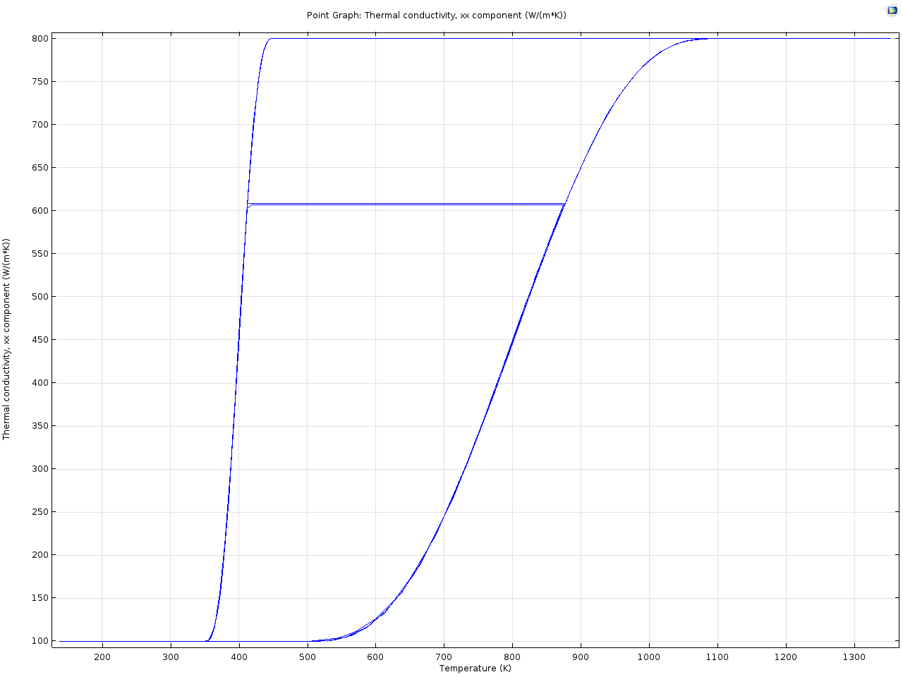

Posted: 10 years ago 2016/02/23 5:26 GMT-5
After several cycles of heating cooling and 2 non complete heating cycles, the thermal conductivity of the domain looks like the attached picture
Best regards
Julien
