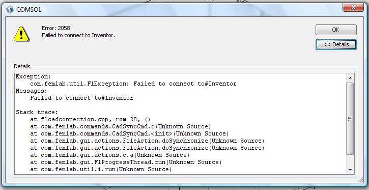

Hi Lorant!
Seems like Micheal is not the only one facing this problem... I get the same eroor-code (a screenshot from the error-details is attached). I have installed Comsol 3.5a with the latest updates (3.5.0.608 2009/05/11) and Inventor 2010. If there allready exists a solution for this problem, it would be the best to post it here - otherwise, I'd really liked to get a solution :)
I have installed COMSOL and Inventor in two different partitions, maybe that is a possible reason that this error occurs...
Thanks in advance!
Dominique
[QUOTE] [QUOTE] Ok so I purchased and installed inventor 2010 same error and several thousand dollars spent, any other ideas? Michael 408 505-2170 [/QUOTE] Hi Michael, If you still experience this problem, please contact the support team, and I am sure that we can sort it out. Best regards, Lorant COMSOL AB [/QUOTE] Hi Lorant! Seems like Micheal is not the only one facing this problem... I get the same eroor-code (a screenshot from the error-details is attached). I have installed Comsol 3.5a with the latest updates (3.5.0.608 2009/05/11) and Inventor 2010. If there allready exists a solution for this problem, it would be the best to post it here - otherwise, I'd really liked to get a solution :) I have installed COMSOL and Inventor in two different partitions, maybe that is a possible reason that this error occurs... Thanks in advance! Dominique

Posted: 2 decades ago 2009/08/06 17:03 JST
Hi Lorant!
Thanks in advance!
Dominique

Hi Lorant,
yeah, I found those instructions in the userguide, but that was not causing the problem. Comsol is now running with Inventor without any problems. COMSOL is only able to connect to Inventor when a Geometry is opened in Inventors Workspace. The error-message should be sth like "not able to import geometry" instead of "unable to connect".
Thanks a lot, have a nic e day,
best regards,
Dominique
