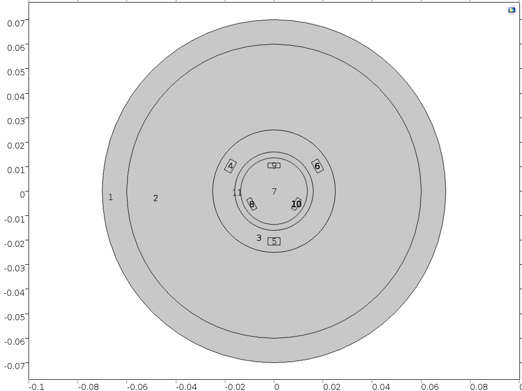

I am trying to set up a 2D model in which the inner circle of permanent magnets (domains 7,8,9,10 - see attached picture) is moving in reaction to the magnetic field interraction with outer circle of permanent magnets (domains 3,4,5,6 - see attached picture). The outer ring is rotating along the center of the system, while the inner circle should be free to move (translation plus rotation). The inner circle and the outer ring are creating the first identity pair, while the outer circle and the outside domains (domains 1,2) - the second pair.
