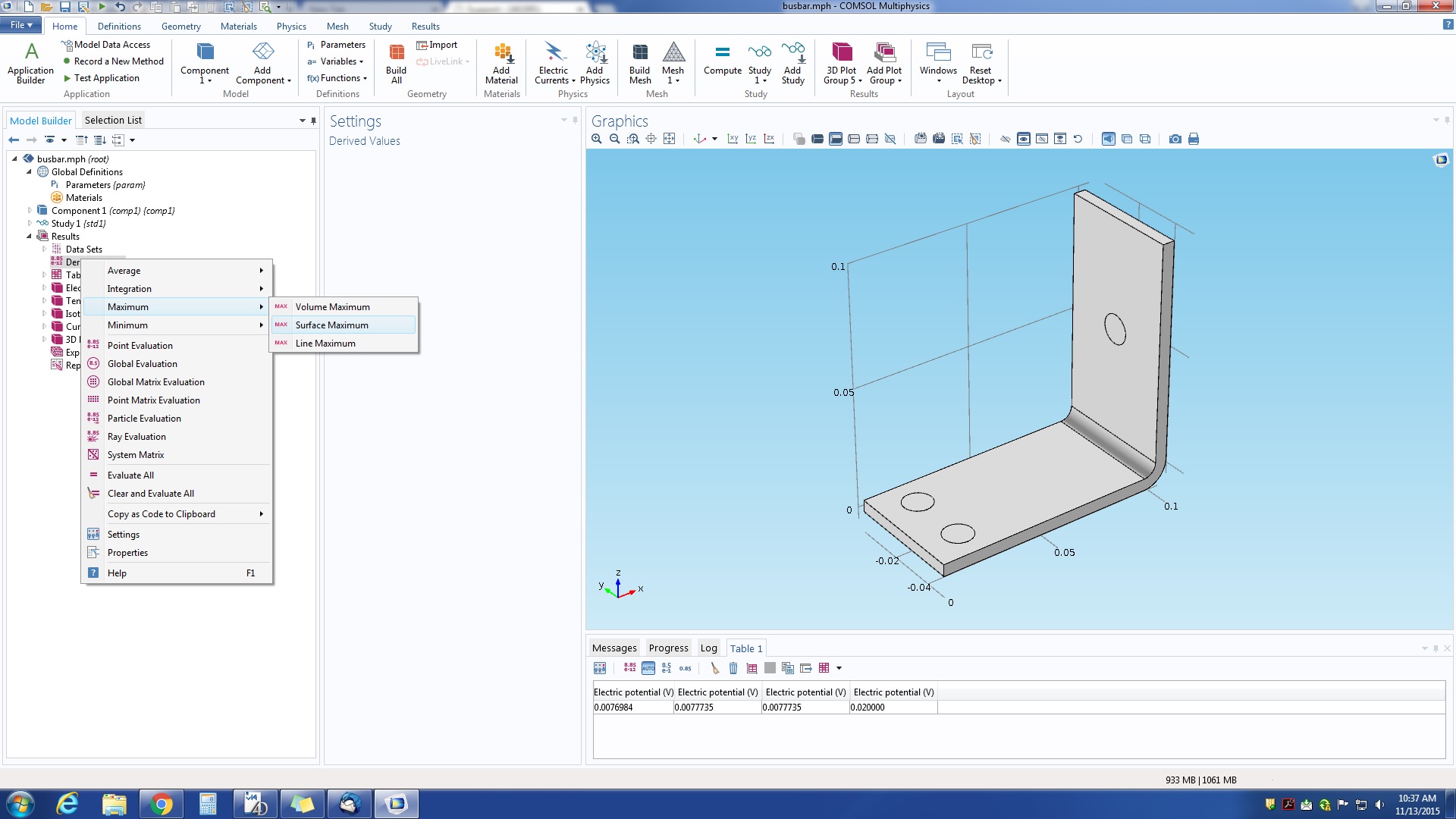

Hi Berry,
Expand the Results node, right click on "Derived Values". Choose "Maximum", and then select "Surface Maximum". That will allow you to select specific boundaries.
Under Results->right click Derived Values->Mouse over Maximum->Click Surface Maximum

Please see attached screenshot

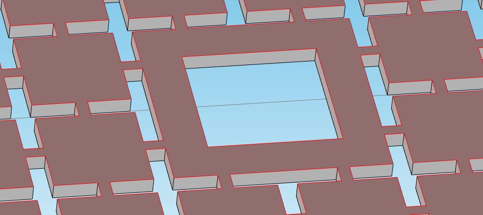

Can I select half a surface? Or, how may I split a surface into two, an inside and outside, and then select the inside? (see alpha.jpg - of the selected surface, I want to select the innermost ring only)
For example, to display only a part of the geometry being evaluated, we can use a 'filter'. Can I do something similar for the surface maximum evaluation?
