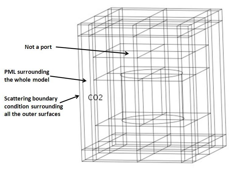

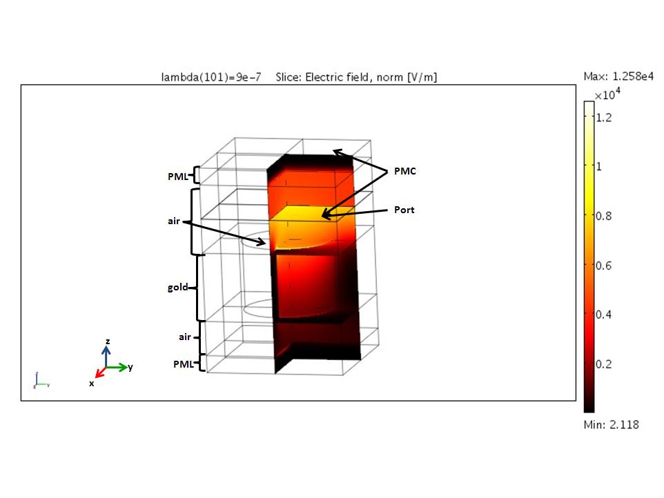

And now I would like to simulate for a SINGLE hole. So I think additional PMLs are needed to cover up my whole model, including the lateral dimensions. But I realized that I can't define the inner boundaries of PML as continuity, so my result was deemed to be wrong. Another WRONG way to do it is by using scattered field formulation (scattered harmonic propagation) without a port (attached picture 2) -- it is wrong because scattered field formulation only works well for the case where the scatterer (in this case the gold film) is completely enclosed by one type of medium.
