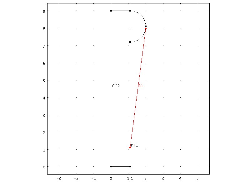

I have a problem to mesh a thin shell (3D model attached).
Here is also a cross section illustration to show how did I plot this shell.
A rectangle and semicircle are connected, then plot the tangent from PT1 to semicircle to form the outer boundary of
shell. Finally rotate this 2D model around x=0 and form a 3D shell.
Following the discussion about meshing a thin plate in this forum, I tried to start the mesh from edge, boundary then the subdomain. But they all failed, and have error message:
Error: 4100 Failed to generate mesh for subdomain,
-subdomain1: Failed to respect boundary element edge on geometry face.
Internal error in boundary respecting.
I think this problem stemed from the sharp angle at PT1, because when I increase this angle value, there is no error message.
BTW: at RHS of cross section there are two points close to each other, and will form a narrow boundary after rotation, which make the mesh more difficult. Can I remove the point?
Any suggestions will be appreciated.
yours,
Yao
