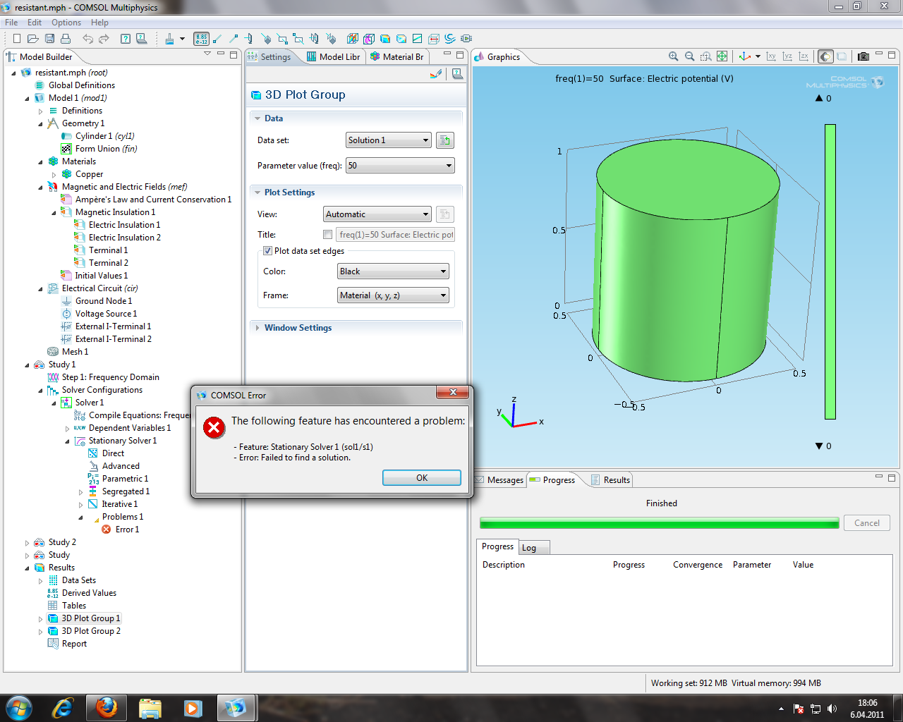

I have plane to used MF module, because there I can calculate the pressure of liquid metal......but, what this mean: (it's not in MF since you do not solve for "V").....what this "V" means ?, how i can solv "V" before if I don´t have working circuit....?
I've tried allredy three days to connect my circuit to model but always some error comes :(
I can´t even normal resistor connected to a power source, some error comes all the time, see attachment.

V is the voltage, MF solves for A but not V, (MEF does for both) check the dependent variables, so it seems that you cannot link explicitly to the circuit port.
But there must be a way around with MF, perhaps by defining the circuit voltage as an external variable and using that in the MF, I would have to check (I'm stuck in some structural just now, I'll try some time later)
But careful when mixing MF and MEF in the same model (normally you need only one of them) to avoid getting confused with the similar variables and names
My way around when I get errors, is really to start fundamentally simple and build again up step by step
I believe you have missed something in the CIR model, your node 1 is "hanging"

I built a simple model of resistance of MEF module and I tried to connect the AC power source to resistor.
Please, could you tell me what is wrong with it ?
I just can not be connected to the scheme of model. All time same error comes. How difficult can it be ? :)
If you look at this model and correct the error could you please send it back to me. Then I can perhaps understand how to combine the model and scheme.
Thank you !
Heigo.

first of all, if you have "just" a large Cu cylinder, why use MEF?, EC should do, the magnetic field will anyhow be expelled from the Cu, and if you do not put some air around to allow the field lines to loop it will not make much sens
Then with a large block the resistance is small 1/(sigma[S/m]*pi*(0.5[m])^2/1[m]), and with 100V applied you will get a large current about 5[GA]
if you reduce the wire diameter to let's say 1 [mm], then remove the "Preserve aspect ratio" in the "Definitions - View 1" node, this will compress your model axis to make it easier to select the items, even if a circle becomes a square in he geom view, it will be better once solved.
Then try rather EC and CIR to start with, later replae EC by MEF and add some air around
