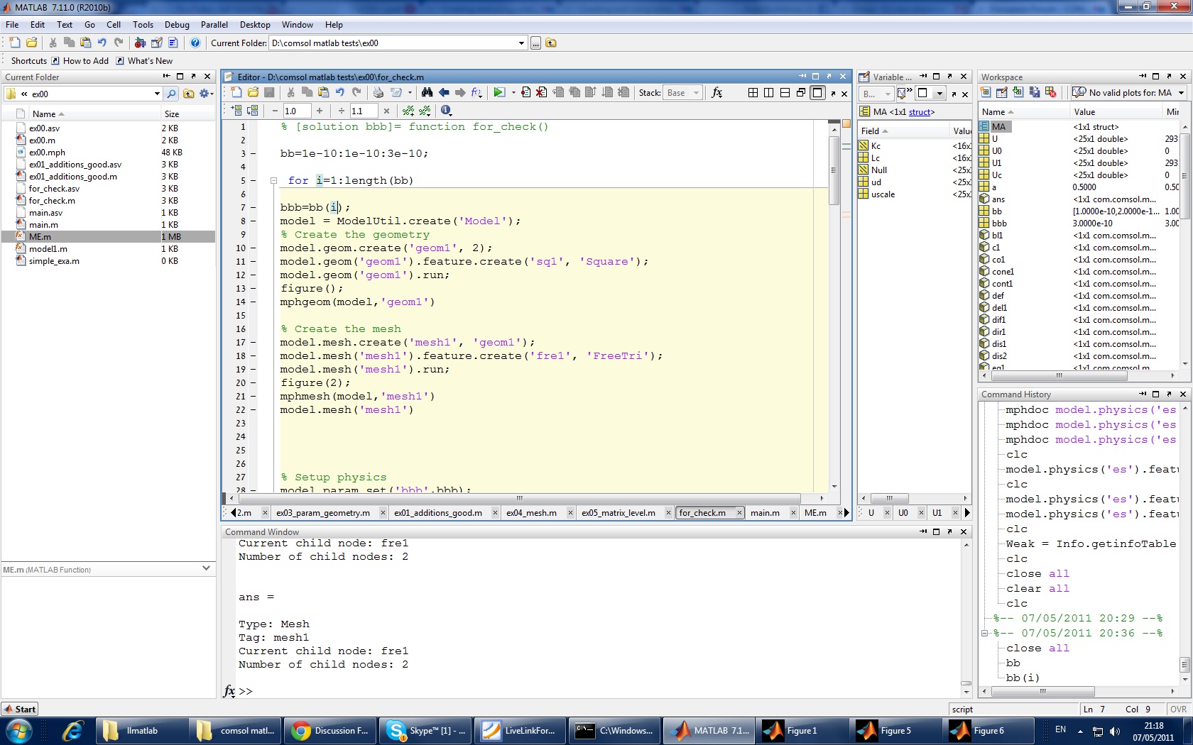

now my question is:
if it is possible to run my model as like it was a function
attached
for I.e the picture show i have a for in my model
but i want the for to be outside the model and to run the model
as if it is a function that the for is calling for it
Arye
