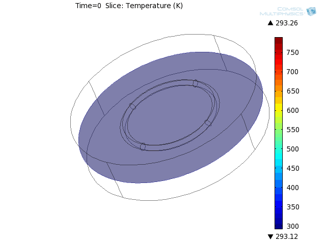

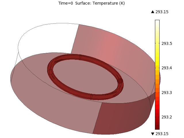

In these results, however, there seems to be something wrong. I attacked a GIF file to show you the result - it looks like a heat diffusion from certain places on the coil, and clearly it shouldn't be that way, since the problem is totally symmetrical. The only thing I could think of that isn't symmetric is the mesh - perhaps refining the mesh would help?

According to your advice, I figured it can't do any harm to rebuild the model, so I have, and I created once again the GIF file of the results - a horizontal slice(temperature), from time 0 to 1000(attached). here too, there seem to be two spots that look like their initial temperature was different.

I also noticed that the current results, has at times areas with temperature lower than 293.15, the default for all the domains. clearly something is wrong. I cleared solutions to minimize file size - computation should take around 90 seconds.

In time dependent solving of thermal models of solids, if you get negative temperatures (or lower than the minimal ones) with only positive heat influx, it often indicates that you are not respecting the mesh size and time stepping correctly to resolve the thermal gradients you have.
There are two time constants in thermal one must whatch (often linked to the BIOT number for solids), particularly in time dependent solving:
1) the heat capacity time tc = rho*Cp*Vol/(h*Surface) where rho is the density [kg/m^3], Cp the heat capacity [J/kg/K], Vol is the domain volume [m^3] and S the surface [m^2], while h is the heat exchange parameter [W/m^2/K]. This is typically the thermal inertia of the domain.
2) But there is also the heat diffusivity alpha = k/rho/Cp where k is the heat conduction [W/m/K] and alpha has the dimensions of [m^2/s]. The corresponding diffusion time constant is td=L^2/alpha, where L in [m] is the caracteristic length considered (mesh size, or layer thickness or ...) y the way "ht.k" is no longer defined as a scalar in V4.2a (perhaps not in earlier versions either) one can use ht.kxx instead, the first diagonal heat conduction tensor element, (but do not get confused with the COMSOL "xx" tensor suffix notation, and the dependent variable "xx" suffix for second derivative along x, the first spatial direction ;)
if you select L to the average mesh size ("h" [m] in COMSOL not to be confused with the heat exchange "h" [W/m^2/K] used above) then it gives you a time value td you should ensure you respect in your time stepping. There is a simple model where I illustrate this in another thread (a few days ago)
