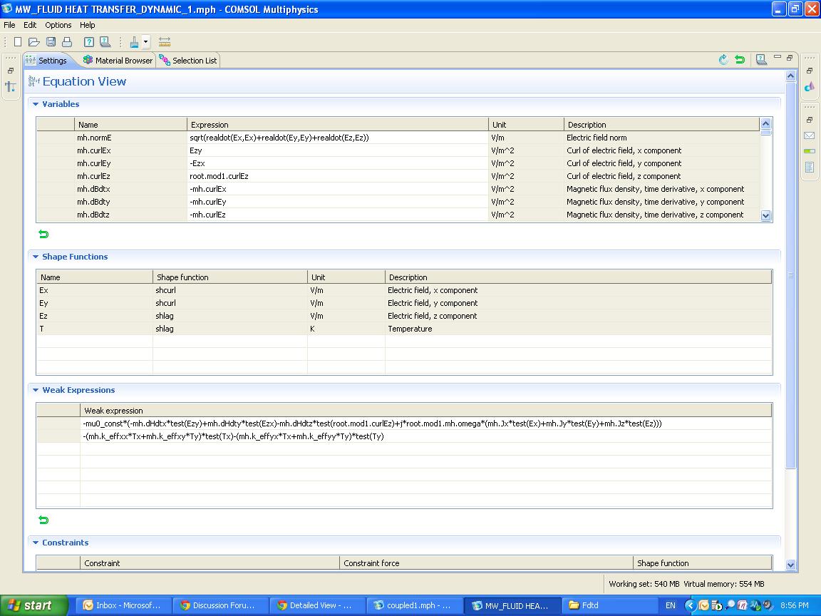

Thanks Ivar for your response!
I tried to look at the variables but they are huge in number and are represented in weak form.Please have a look on the attached image.
Can you please explain some equations from these variables and then I will continue with them?
Many thanks for your help.

indeed there are many and far from obvious to rapidly understand like that. That is also why I'm not even trying to sort them all out myself. I trust COMSOL for the general equation sets, so long the results compare to my model validations. Only if not, then I dig into the equations for specific cases, but that takes quite some time, indeed. And I do not have more doc than you, I'm also a (convinced) COMOSL user, but not linked to any of COMSOL internal developments ;).
What I can say though is that phase change is not included by default. That is anyhow delicate to express as phase change means geometry changes, and even topology changes (hence domain and boundary ID renumbering) and these are difficult to handle. There are a few examples and discussion of the forum on how to change the material properties (Cp(T)) to mimic closely the extra enthalpy change due to phase change, wich is one way to treat the HT issue, apart that when material changes into vapour it will escape from the domain and you need other physics to describe it, than the solid or liquid physics used. But phase change can be considered, check the model library on the boiling water example. the extra work comes when you mix it with e.g. RF heating
By he way forget 4.0, use only the latest versions as the early ones were not fuly ironed out and the stability and possibilities has greatly improved with the latest issues
