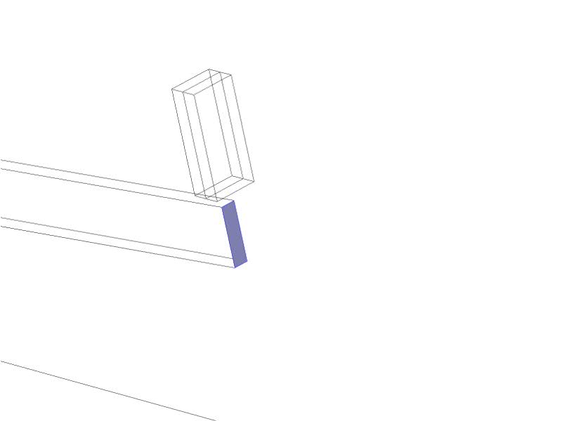

Picture description:
The highlighted rectangle is the applied inlet where my previously defined U_profile is placed. The bottom line of the highlighted boundary is z=0.
Thanks for all your help in this.
