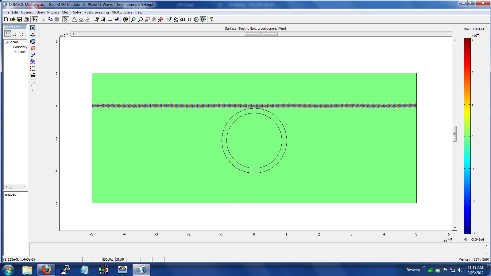

I've built up a In-plane TE waves model with boundary mode analysis to use the solution mode at the excited port. (as attached figure) The procedure I did was pretty much like the waveguide adapter case in the manual (just it's 2D in my case). But when I want to solve the S-parameters, use the the global variables plot and choose the S21 dB parameter. The error pop out and said that "S21dB_rfwe is not a valid expression". I don't know where is not correct to cause this message. How can I get the transmission loss in my structure? Hope that someone can point out if there's anything I did wrong. Thank you so much.
