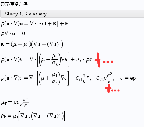

I want to study turbulence topology optimization and I want to add penalty term to the turbulence model equation preset by COMSOL. How to achieve this?
