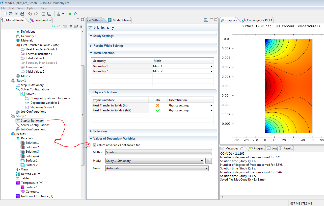

you are right that was 4.3, but you are lucky I still have a 4.2a running here it is
Do not forgget to use the solver 2 stationary node bottom: turn on the Values of dependent variables to point to the first simulation
I hope its more or less what you wanted ;)
