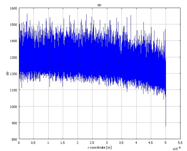

if your pp is discontinuous, does that mean you have an "up" value and a "down" value that you might read in and average ?
Or do you want to generate an average curve on your noisy data ?, in which case you could enter it into an interpolation function, or use an optimisation run to get a smooth parabolic or polynomial fitting

Hi Ivar,
Thanks for the quick reply.
You are right in both cases: pp is discontinuous meaning below the boundary, in which I plotted pp, it has high and above that boundary it is low value. So, I am guessing that there is an up value and a low value but not located in the boundary that I have plottted. However, I do not want to read the average pp. I want to remove the noise and obtain a smooth average curve as COMSOL is solving.
So, I want COMSOL to solve my problem, extract pp, smooth it by "optimisation run to get a smooth parabolic or polynomial fitting", and use the result to solve the next step. Can you please tell me how to do that, or send me the link/title to the document that explains it in Comsol 3.5.
Truely appreciate your help
Suzan

Hello
Sorry, but I do not know where to look for something like that, what I do not understand is how you can get such a noisy variable from something solved, as I believe it should be locally smooth, possibly with stair steps, but not noise like that
Then if pp is a value derived from the domain then the boundary will get, by heritage, an average value from the "up" and "down" domains. If you are in union mode then you have normally continuity mode, hence pp_up=pp_down=pp_average but if you have a true discontinuity (t"hin" boundary property or assembly mode) then the up and down may be different and hence pp_average in between. So be sure you know if its pp_u, _dovn, or _average you get as result.
Next for me my first impression is that you are seeing numerical noise, perhaps even from a mesh density issue
Now what could perhaps be done is to add "pp" as a new local dependent variable and request that its second or third derivative is =0. But how to do that depends on your model set-up and the pp equation, anyhow not something I do everyday
