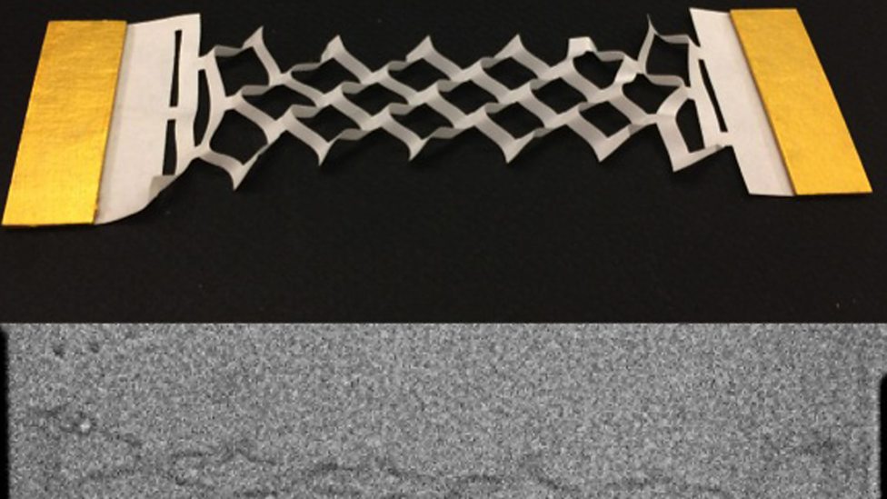

I'm trying to model the deformation of a ribbon of SU8 with a pattern of cuts (kirigami) undergoing a 1D tensile loading. The loading is kept in the xy plane, but the force causes a twisting of material and buckling in the Z direction. Attached is an example photo of it occurring to paper with similar conditions. I cannot recreate what is happening physically within COMSOL
I've attempted this as a thin solid as well as a shell, both ending with the same result of only showing strain and deformation within the xy plane. I have assigned one end as a fixed constraint while attempting edge/boundary loading or prescribed displacement. I have also tried conducting a Linear Buckling study, but it doesn't provide me with the results I need I'm assuming because the loading is tensile and not compression. Attached is the file I'm trying to work with. I'm still new to COMSOL so I may be doing something wrong. Are there any suggestions for what may work or that I'm missing?

That photo is fantastic! Impressive.
However, I think a primary issue with simulating it is symmetry. It appears the structure is symmetric, yet the deformation is not. Something needs to break the symmetry: the equations won't do so on their own. This may not be your issue but it's the most noticeable thing I see.

I still can't seem to get any out of plane motion without adding in a small z-direction force. And when I do add the force, the entire geometry acts as if it is a solid member. If anyone would be able to expand on how to work with equations/symmetry or help further I would appreciate it.

This is a rather difficult analysis, but here are some hints:
1. The most important is that the problem is strongly geometrically nonlinear. So you must activate geometric nonlinearity in the settings for the study step.
2. I would recommend a loading by a prescribed displacement, which is more stable.
3. The load must be applied gradually using an auxiliary sweep.
4. Solving a buckling problem is a numerically very sensitive problem. Please study this example, which deals with how to pass the instability and get into the post-buckling state.
www.comsol.com/model/postbuckling-analysis-of-a-hinged-cylindrical-shell-10257
Along these lines of that example, I think that using sqrt(w^2) as the controlling parameter could be a good idea.
