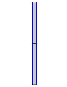

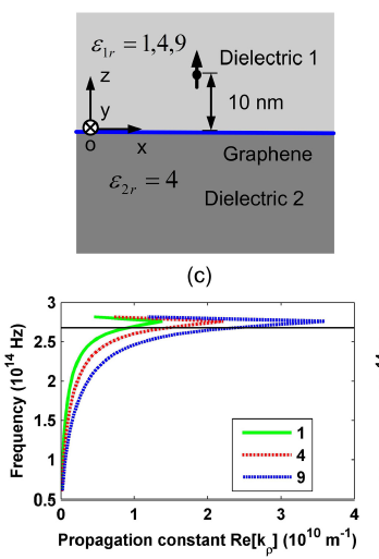

I am trying to get the dispersion curve of graphene in the dielectric/graphene/dielectric structure like ref.jpg.(only in x direction)
I use periodic BC on left-right side and set the floquet vector kx sweep and eigen-frequency solver to find the relationship of eigen-frequency and wave number kx.
Is it reseaonable? I cannot get the right result computed like ref.jpg.

Hi everyone.
After some trying, I found that based on my model, if I change the width of the whole model, the result also changes. That is not a expect situation because I set the left-right side as periodic BC and it should be with the same result.
Really looking forward to someone's help
Han
