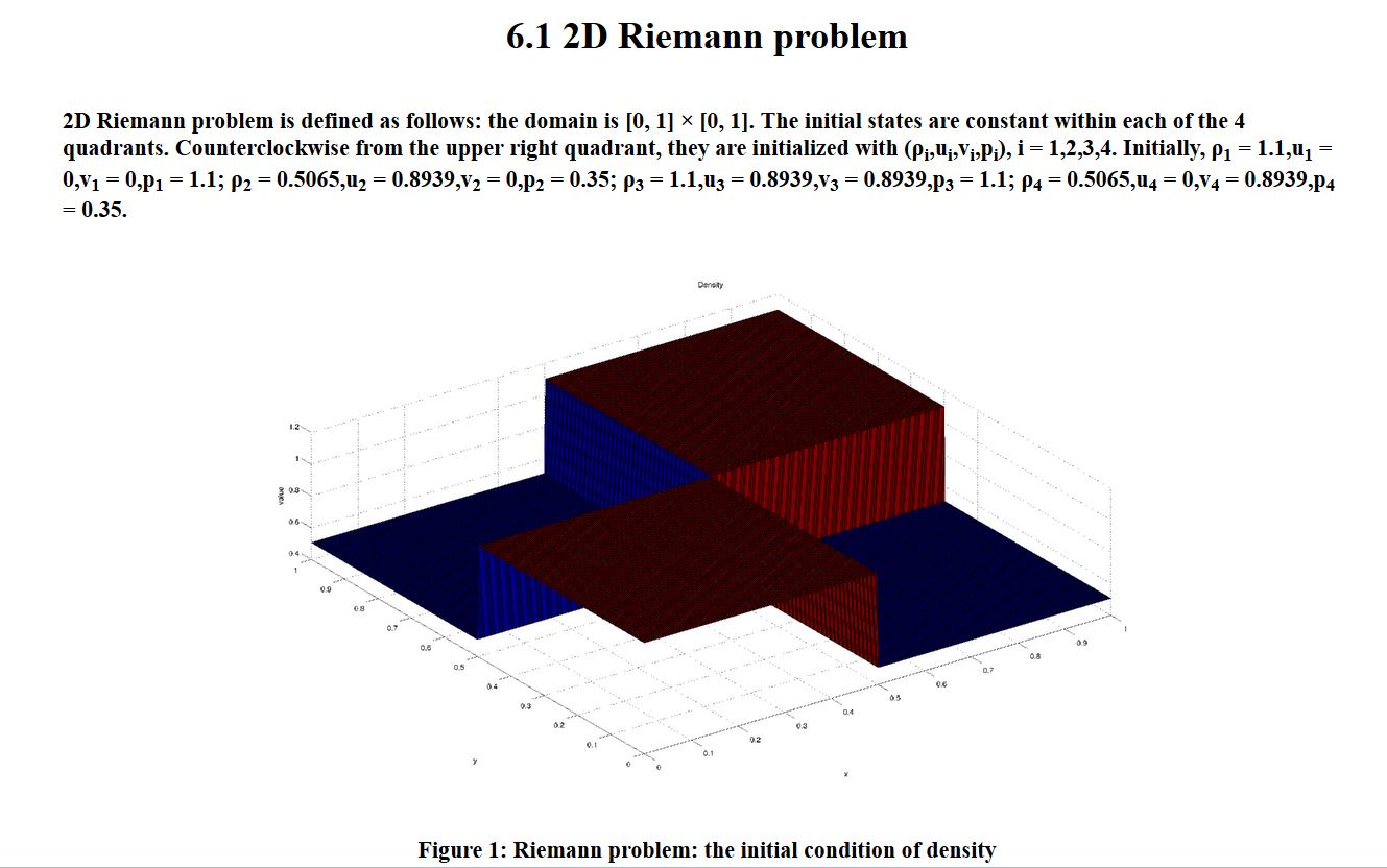

The initial condition is read from a 2D Riemann problem (6.1 2D Riemann problem) from: www.oxygen8.org/HTML/numerical_pdes_final_project/MUSCL_for_2D_Euler.html.
And this initial condition is expressed by Matlab function. For example, density is expressed by function initial_rho, as attached.

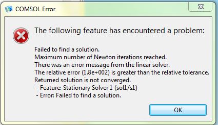

My question is, I cannot get a solution from this module, the comsol error informing that "Failed to find a solution. Maximum number of Newton iterations reached." I tried to increase the iteration number, but it seems it cannot figure out this problem perfectly.
