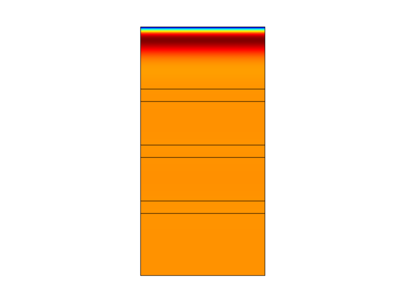

Posted: 2 decades ago 2010/10/12 6:38 GMT-4
Hi david,
I see your modified configuration to my model.As result I see a surface plot where the field is overall zero except close the top PML (becouse it has been absorbed, i suppose).It don't seem to work well, I mean i don't see the field inside the domains.I want a configuration (PML+Port was the best case in previous versions) for witch i can excite a plane wave in the interior domains and it can be scattered by any possible scattering object inside them.I need the PML on top and above side in order to absorbe any scattered component of the wave.
With regards ,
Giuseppe.
Hi david, I see your modified configuration to my model.As result I see a surface plot where the field is overall zero except close the top PML (becouse it has been absorbed, i suppose).It don't seem to work well, I mean i don't see the field inside the domains.I want a configuration (PML+Port was the best case in previous versions) for witch i can excite a plane wave in the interior domains and it can be scattered by any possible scattering object inside them.I need the PML on top and above side in order to absorbe any scattered component of the wave. With regards , Giuseppe.
