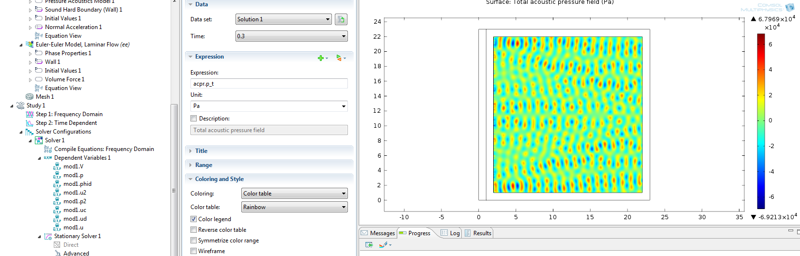

In my comsol, I have one study only. In this study I have two steps:
Step 1: Frequency domain at range (1.5,1,2.1) MHz
Step 2: Time dependent domain at range(0,0.1,1) s
In my result, I can only visualize them at the time dependent range, I cannot visualize them at the frequency domain range.
How do I visualize it at the frequency domain range?

Hi Badri,
Make sure that the plot is based on a data set that corresponds to the solution step you want.
If a data set is not automatically created for you at the solution step you want, you can add a Store Solution node to your solver sequence to force one to be created.
Hi Badri, Make sure that the plot is based on a data set that corresponds to the solution step you want. If a data set is not automatically created for you at the solution step you want, you can add a Store Solution node to your solver sequence to force one to be created. Best, Jeff
