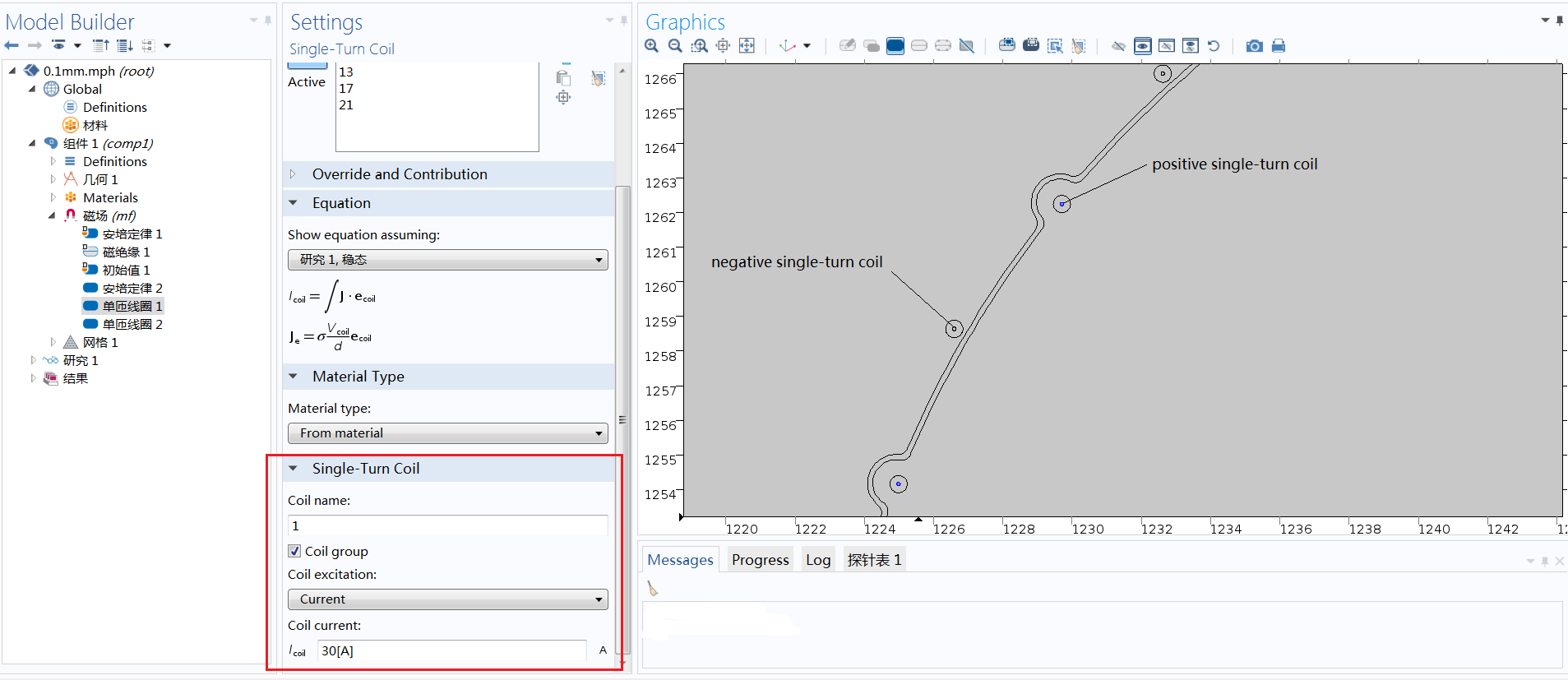

I simulate a 2-D modle.There are two single-turn coils that is series connection. The parameters of the coils are all same except their coil currents are contrary.So i should make a one coil's current is a positive number and other coil's current is a negative number?Or what should i do that can express their coil current is contrary in 2-D modle??

The single turn feature can have sub node "Reversed Current Direction ". Rght click on the model tree.
