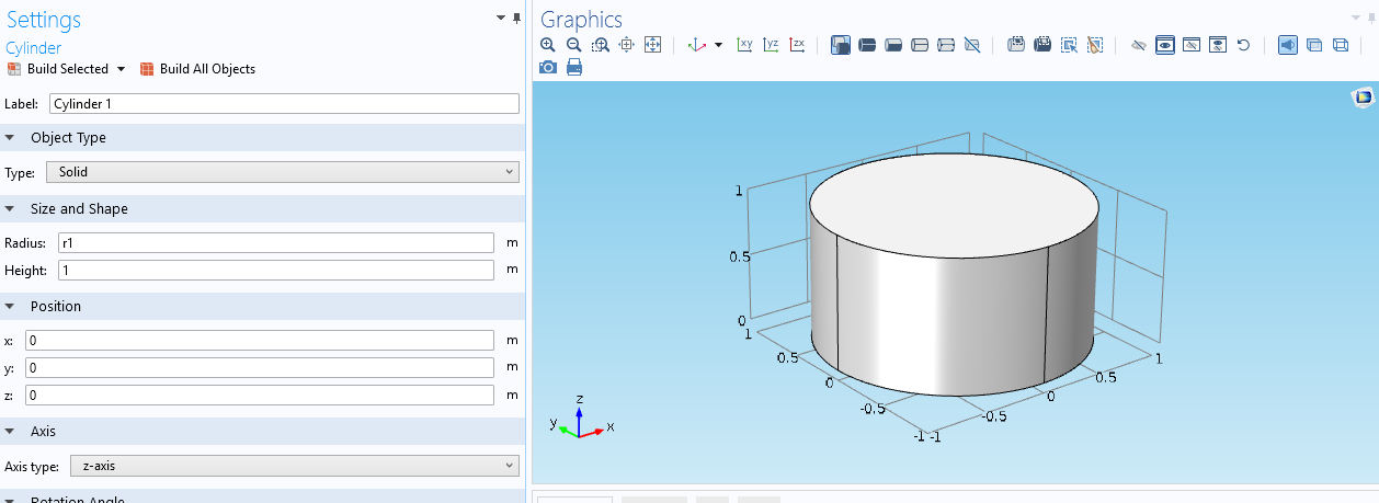

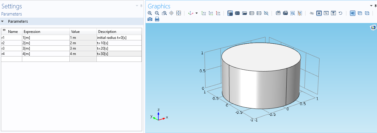

Posted: 10 years ago 2016/02/03 10:27 GMT-5
maybe you can define a piecewise function for the radius in your model, which takes a new value after every ten seconds (so as a function of time). If the name of the function is e.g. my_radius, then enter my_radius(t). Hope that works, it is the only idea I have to implement what you want.
Kind regards,
Peter
Hi, maybe you can define a piecewise function for the radius in your model, which takes a new value after every ten seconds (so as a function of time). If the name of the function is e.g. my_radius, then enter my_radius(t). Hope that works, it is the only idea I have to implement what you want. Kind regards, Peter
