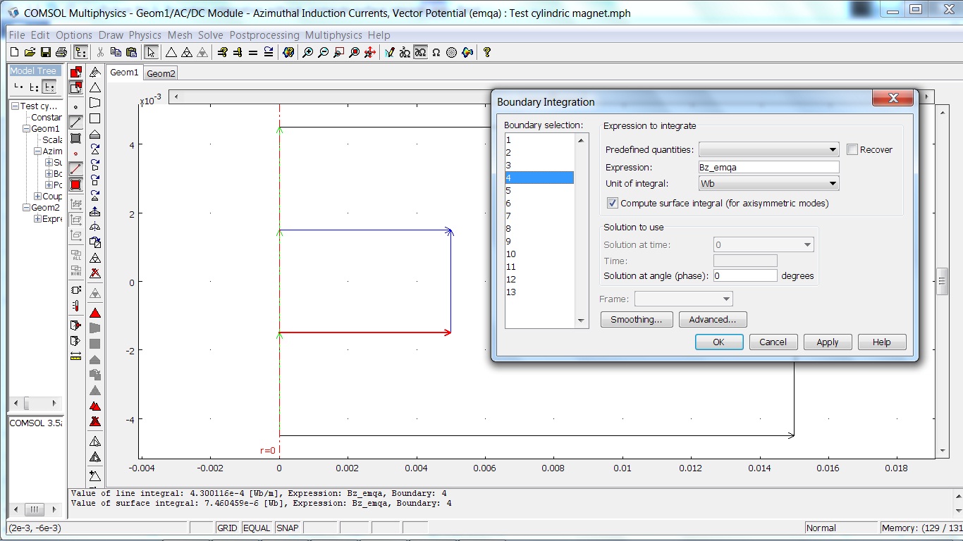

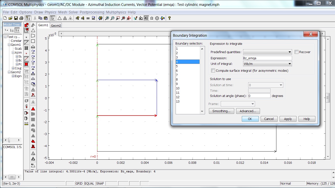

CASE A : If I just select go to POSTPROCESSING> BOUNDARY INTEGRATION> AND I SELECT ONE BOUNDARY OF THE MAGNET I GET THIS RESULT (SEE PICTURE 1 IN THE ATTACHMENT)
"Value of line integral: 4.300116e-4 [Wb/m], Expression: Bz_emqa, Boundary: 4
and if I multiply this by 2*pi *0.005m (the radius of the permanent magnet edge) I get
1.350921284e-5 [Wb]
CASE B: If I select the "compute surface integrals (for axisymmetric modes)" then I get.
7.460459e-6 [Wb] (SEE PICTURE 2 IN THE ATTACHMENT)

a partial reply for the 2*pi*r (as you hae many questions, and some are far more time demanding than others ;)
Do not forget that COMSOL is always working in 3D, but if you select 2D it assumes a default depth of 1[m] (slightly physics/application mode dependent though pls check carefully each time) and in 2D-axi it's the "loop length" = 2*pi*r (for each value of r) that is gicing the "third dimension".
Now if you integrate an edge in 2D axi you get a result as [something/m] because it is per "[1/m] loop length". If you check the tick box "evaluate surface integral", while having an integration over an edge, you are in fact simply multiplying internally by "2*pi*r*Your_expression" inside the integral (not 2*pi*0.03[m]).
In comsol the integrations are not clearly shown up. all equatins are related to a "finite element" hence a small dxdydz volume and it's implicit that everything (almost) is integrated over a volume or a surface or an edge length (or summed over points or node, the latter for reaction force reactf() calculations)
Try it out, with simple surfaces, (mesh the result and solve "get inital value" as integration postporcessing is done on the meshed entities)
