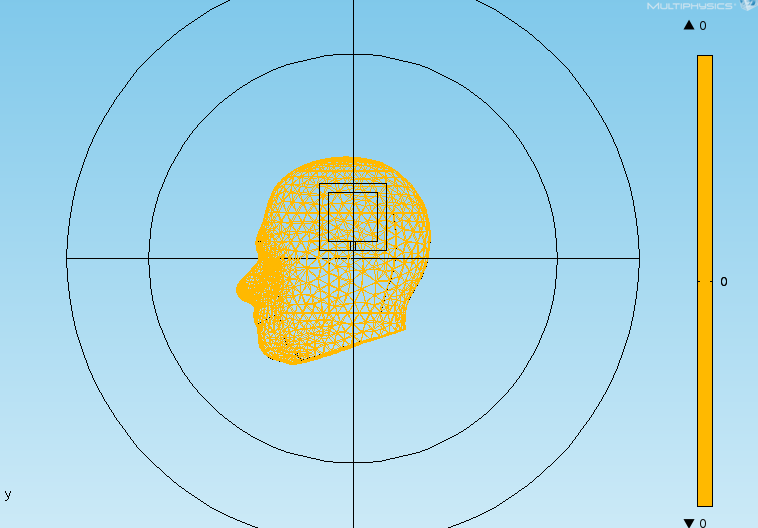

I was going through the tutorial for Absorbed radiation (SAR) in human brain
www.comsol.com/model/absorbed-radiation-sar-in-the-human-brain-2190
I am not sure if anyone else tried this one but I am struggling to gather results for both the SAR distribution and heating. The only change I did to the model and the instructions provided in the link above was the lumped port setup as suggested by Edgar here:
www.comsol.com/community/forums/general/thread/20391/
I have attached the project file (not computed version as it was too big to attach) and the pictures of the results which show no interaction with the study. It seems that I am missing out on something. Can anyone suggest some pathway on this please?
Thanks very much

The problem is in the settings for the Lumped Port. When you have selected "User defined" for "Type of Lumped port" you must give a nonzero entry for "Direction between lumped port terminals". In your case, you should enter (0,0,1) as the lumped port voltage/current is directed along the z axis.
The "User defined" option is provided for cases when COMSOL cannot deduce, from geometry and boundary settings, how to apply the lumped port excitation. I will file an enhancement request to throw an error when you leave required nonzero fields at their default zero value.

The problem seems to be solved. I changed and used "Lumped port<Uniform<Cable" settings. Also found I had a small error in my geometry.
Anyways thanks very much guys, all is well.
