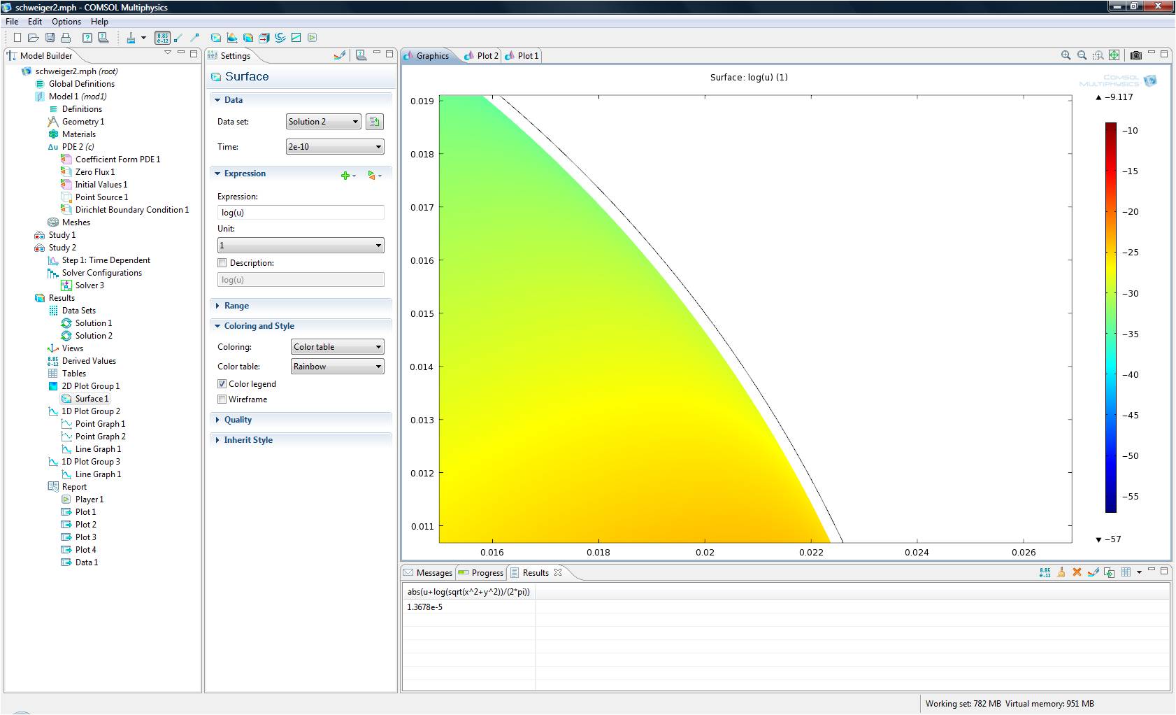

I'm using the PDE coefficient form equation to model a diffusion equation. COMSOL will not give a solution up to and including the boundary. I'm using a Dirichlet Boundary Condition with the concentration set to 0 to simulate a perfect absorbing boundary. Any ideas on what I'm doing wrong?
Attached is a screen shot. I would attach my model but it's 80MB for some strange reason.

There is no valid value to plot near the boundary because you are plotting log(u) where u is equal or close to zero, and log(0) is undefined. Try plotting log(u+eps), for example, where eps is a small number representing the machine precision. In COMSOL Multiphysics the plot is empty where the data is undefined or "not-a-number."
Magnus Ringh, COMSOL
Hi, There is no valid value to plot near the boundary because you are plotting log(u) where u is equal or close to zero, and log(0) is undefined. Try plotting log(u+eps), for example, where eps is a small number representing the machine precision. In COMSOL Multiphysics the plot is empty where the data is undefined or "not-a-number." Best regards, Magnus Ringh, COMSOL

Thanks for the reply. In the surface plot I plotted log(u), but I was trying to integrate the flux across the boundary and it's zero which it shouldn't be.

Just realized that I should probably integrate the concentration slightly inside the boundary since I made it a perfect absorber.
