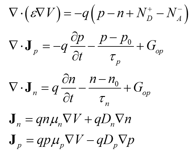

I could ask how to install semiconductor module, but I noticed that the semiconductor module uses stationary equation for conductivity equation.
So, I am going to use my own equation, which is time-dependent, attached to the file.
(My goal is to see time-dependent case of the p-i-n diode)
And I want to model 1-dimensional p-i-n diode, potential energy, carrier concentrations graphs.
