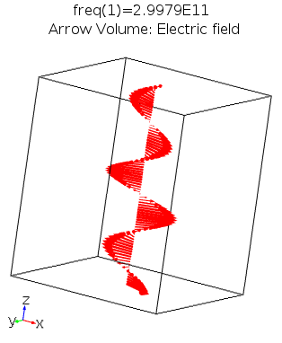

Eugene,
Attached is a model for linearly polarized wave traveling in biaxial media. Wave polarization keeps changing as it propagates, as shown in the attached image. You can still use PML but it requires special scaling.
Sergei
Eugene, Attached is a model for linearly polarized wave traveling in biaxial media. Wave polarization keeps changing as it propagates, as shown in the attached image. You can still use PML but it requires special scaling. Regards, Sergei

Eugene,
Not sure I understand how you can solve this problem in 2D? Plane is required to specify arbitrary polarization of the wave, so you have two dimensions for polarization. Direction of wave propagation requires additional dimension - total 3D.
Sergeo
Eugene, Not sure I understand how you can solve this problem in 2D? Plane is required to specify arbitrary polarization of the wave, so you have two dimensions for polarization. Direction of wave propagation requires additional dimension - total 3D. Regards, Sergeo
