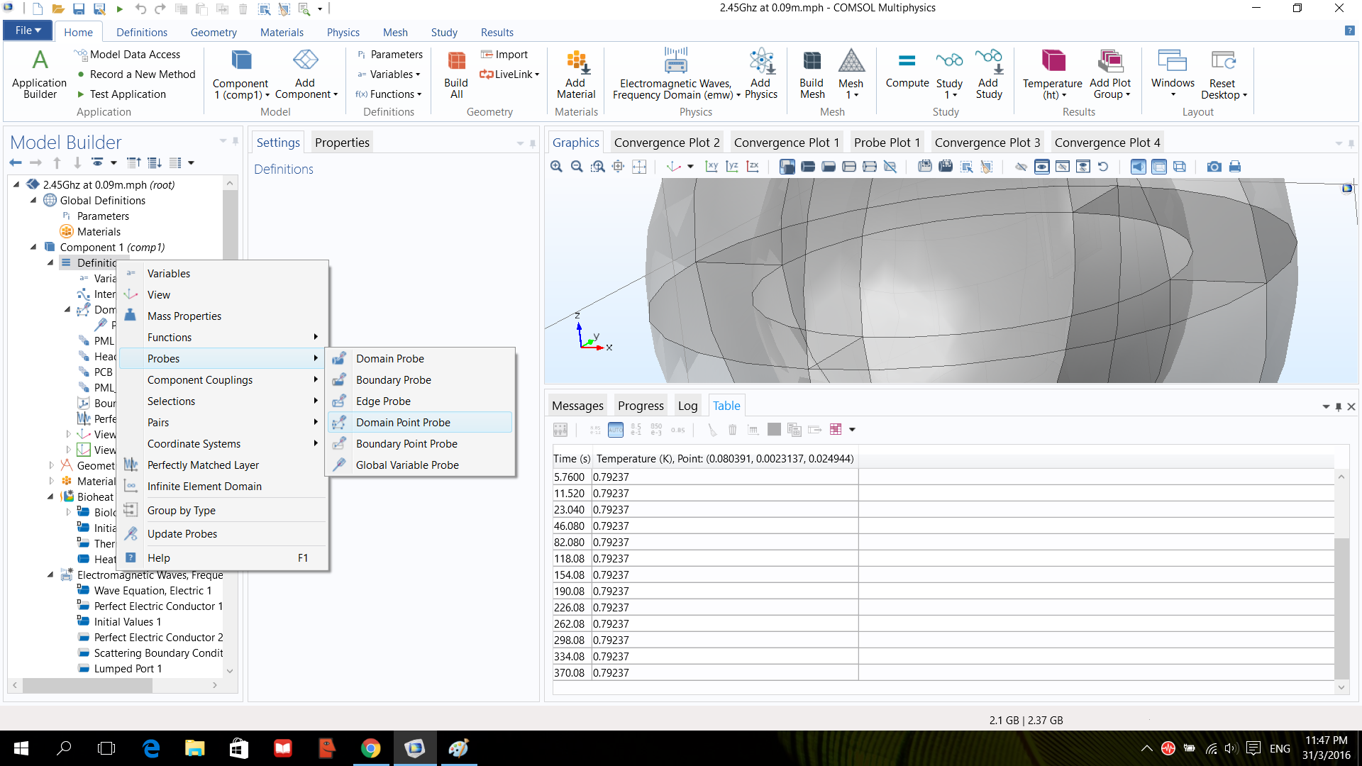

Thanks for the reply! Nope, i was not using point evaluation. i will explain again how i get the result by picture as i couldn't upload my simulation file.
1. i was using the Domain Point Probe under definition node (see picture 1), after that i enter the x, y z coordinates and fix the point.

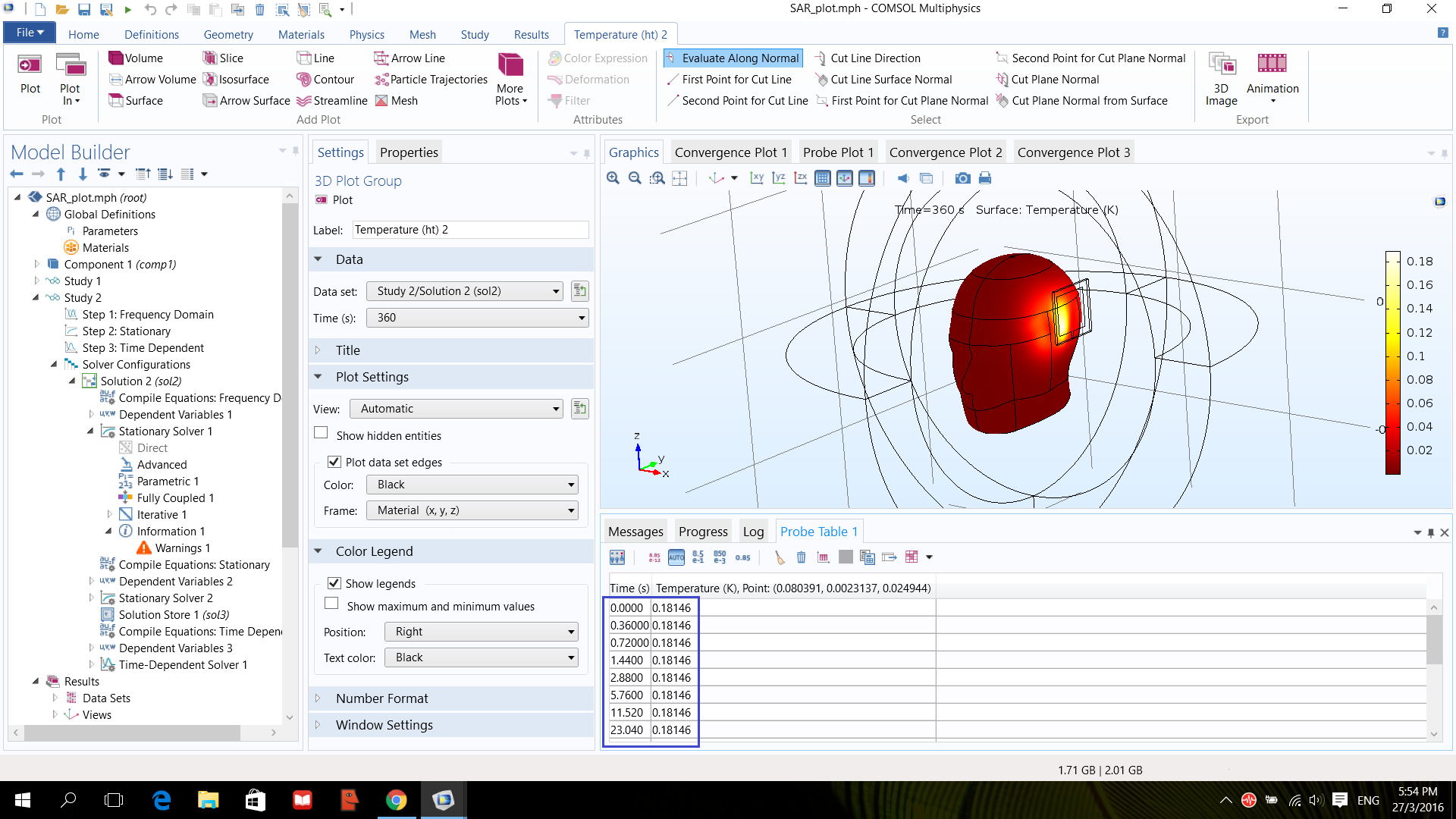

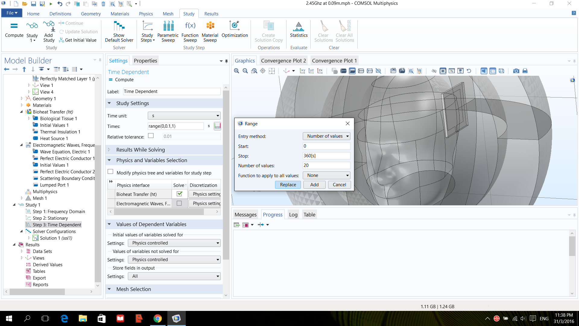

2. i added the time dependent solver under study nodes, and typed the range that i wish to plot with (see picture 2).

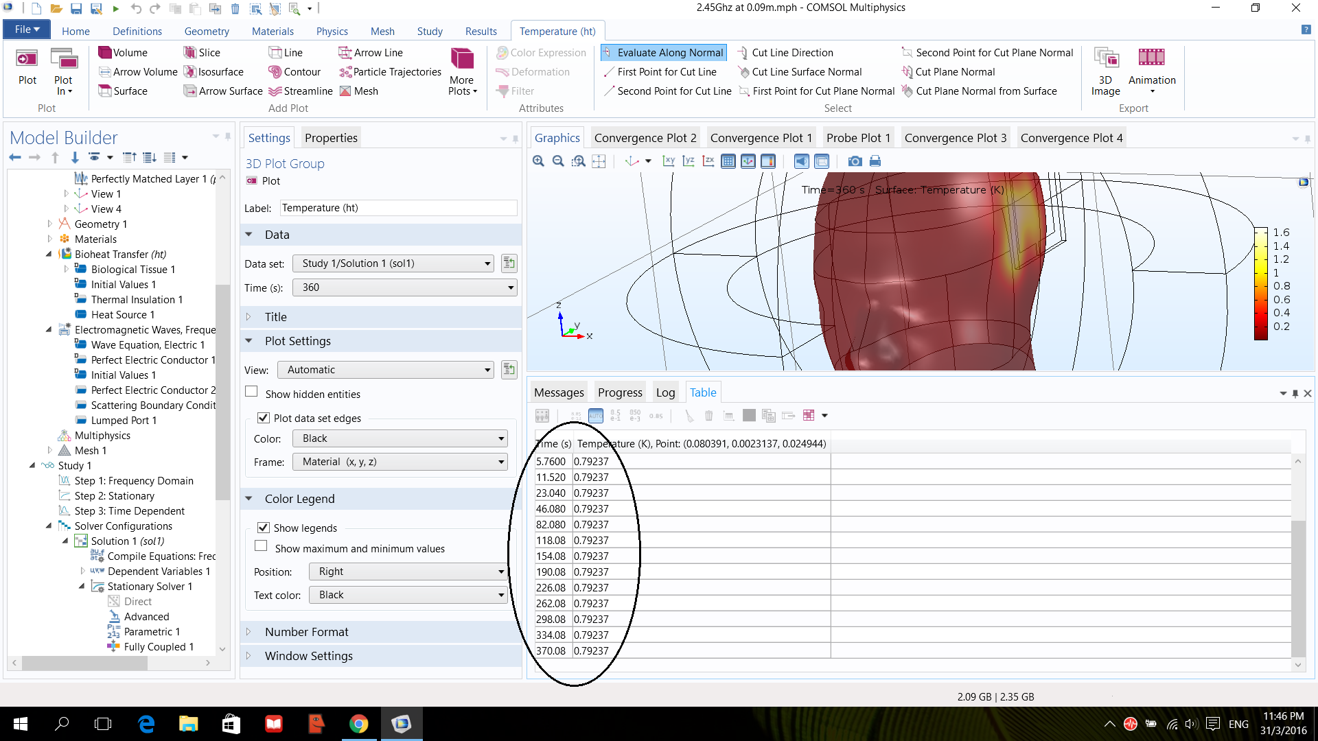

3. i press compute button and the time-dependent i got the this result (see picture 3).
