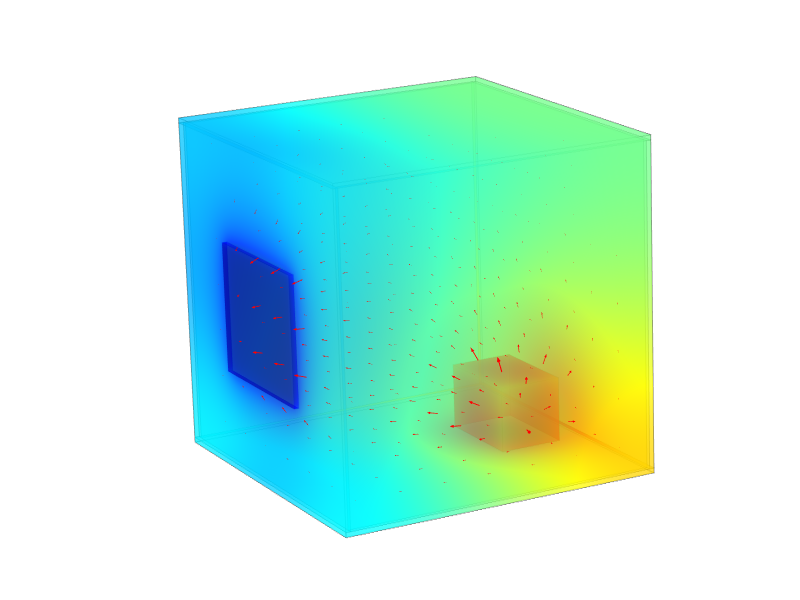

We are french students. We have some difficulties to realize our project with Comsol.
We want to create a room of house with dimension : 1meter * 1meter * 1meter interior.
The walls are plywood with thick 0.015 meter.
We glue on the walls of extruded polystyrene with thick 0.020 meter.
We want to create an opening (window) of 0.45 meter * 0.40 meter on one wall.
Inside this room , there is a heat source (heater 100Watts/meter).
The goal of this project is to study the variations of the temperature field after the opening of the window and
conditions Indoor / outdoor.
please find enclosed a notice of shema.

What are the boundary conditions that you apply? Could you post the mode file? I suspect that you're looking for a stationary solution with the heater up, but no way for the heat to escape..... meaning the temperature blows up to infinity when looking for a stationary solution, hence no solution can be found.

We are not sure for the boudary conditions.We try open boundary for the window, and for the rest we choose Wall
We use heat transfert (htgh) and Navier-Stokes (chns).

please find inclosed our project.
We created an air cube inside of plywood box
And we are not sure for the periodic boundary conditions for the opening.
We want to see the air movement between the inside room and outdoor through the window.
now, we have not realised the polystyrene insulation. We will add this polystyrene after.

You have to think a bit about exactly what you want to model.
In practice, the casing will probably "leak" heat away through edges. If you want to take that into account, you have to make an estimation and add a small heat flux at some edges. What is the temperature outside? Is the heat source homogeneous through the block? Are you looking for a stationary solution or a time-dependent analysis? Etc, etc.
I definitely recommend doing a tutorial. Please contact your local sales office for one: www.comsol.com/contact/offices/
I took a look at your model and did a simple calculation on it, putting a heat source of 100 W/m^3 in the block and a heat flux to the outside through the window at a temperature of 10 degC, with a heat transfer coefficient of 5 W/m*K. I have not taken into account material properties, other effects, etc. You will have to think about that. I'm giving you the model as a starting point, but don't consider it to be holy.

thank you very much for your answer,
We don't take into account "leak" heat away through edges because we have an isolation over the plywood.
the heat source is homogeneous through the block.
if we want a time-dependent analysis how can we do that?
Which coefficient we have to change if we want simulate open or close or half-open window?
We attach our project where we added the material properties (plywood and air).
Thanks again
