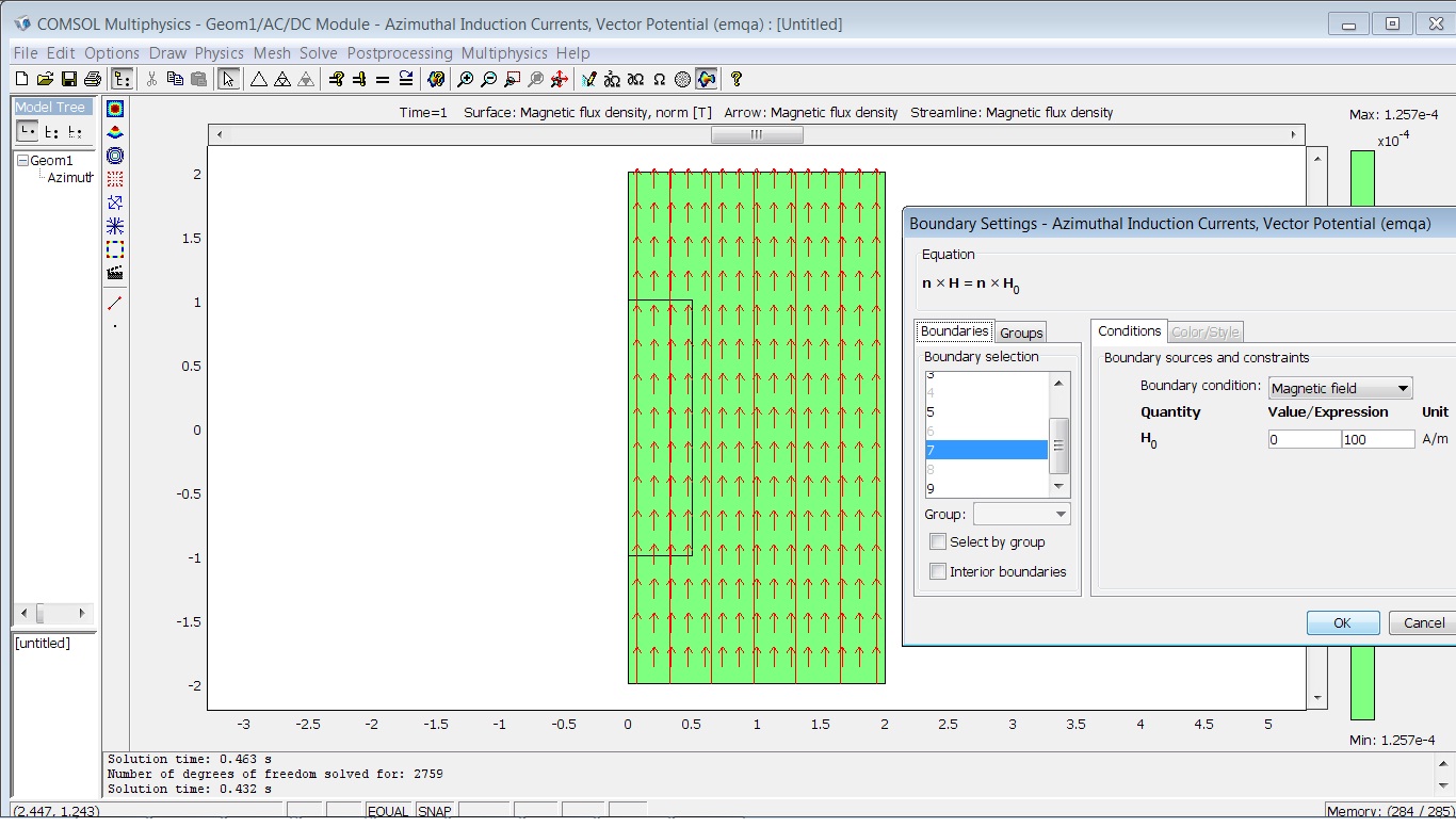

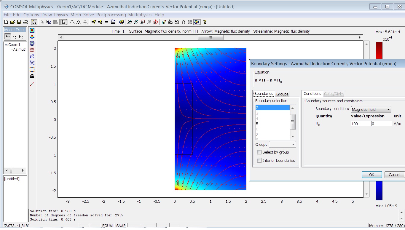

I told you in my other reply that "I think I did it", but I just did it with the no r-component Magnetic Flux Density case, but now I have just realized that it apparently does not work for the case with no z-component Magnetic Flux Density External Field.
It apparently works if I set the Boundary Condition with only z-component (the magnetic flux density vectors should be ALL pointing upward or downward depending on the sign) and the value is the same everywhere inside the domain (two rectangles of air, one for analysis, one for surroundings, just to practice). The boundary condition at the left side of both rectangles is set to Axisymmetry.
But it's not working if I set the Boundary condition to have only R component. In this case I think ALL the Magnetic Flux Density vectors should be horizontal and with the same value and it's not the case. They are inclined and with different values everywhere. (As for the case with no r-component, the left side of both rectangles are set with a boundary condition of axial symmetry.) What am I doing wrong?
I am attaching the images I see in both case to explain better my situation.

Regarding the other question: It is physically not possible to create a homogenous field with a non-zero r-component in an axisymmetric situation. The r-component must be zero on the symmetry axis, otherwise you create a discontinuity at r=0.
