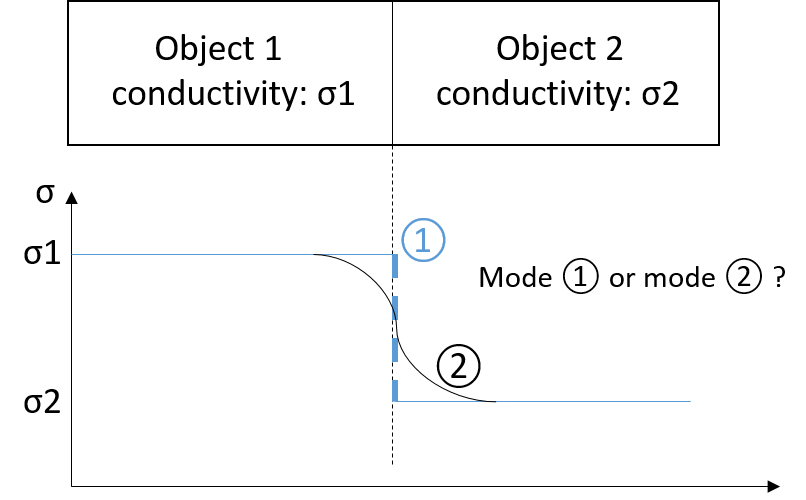

I assign two materials with different conductivity values (sigma1 and sigma2) into two adjacent objects. In the geometry list - Form Assembly(fin), we can chose form an assembly or form a union. Is there any difference in these two methods regarding the sigma value when pass across the interface between object1 and object2? To be more specific, will the sigma1 sharply drop to sigma2 when forming an assembly, while sigma1 decreases to sigma2 in a continuous way when forming a union?

In the document, it says that by default, continuity of the fields and the fluxes will be maintained across the interior boundaries in Form Union but not in Form Assembly. So, I suppose one can say that the conductivity changes in a more continuous way in forming union than in forming assembly when across the interior boundaries?

No, one cannot infer that. The conductivity in each domain will be what you set it to in either case.

Ok. So, in this case, the conductivity will drop sharply to sigma2 when crossing the interior boundaries, no matter we form union or form assembly?

That's right.
