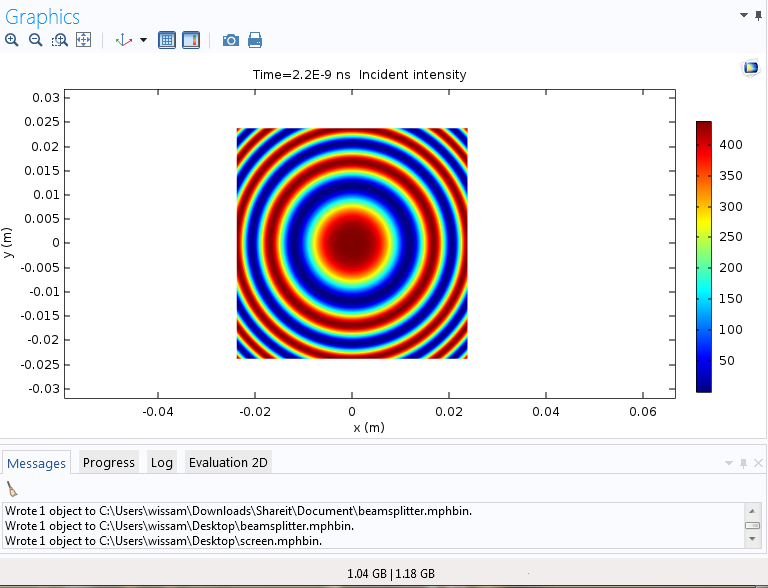

hi ..i am working on michelson interferometer ...i have a 2d plot group of the intensity captured by the detector (see img )..i didn't find a way to read its values from that graph and i would like to export that plot to matlab....is that possible and please if it is show me how !!!

There is certainly a simpler way but you can export data from your graphs (not from the group of graph but from each graph of the group) by doing a right click. Below your result menu you have a node "Export" where you can obtain txt file from your data. Then you just have to import it in matlab.
