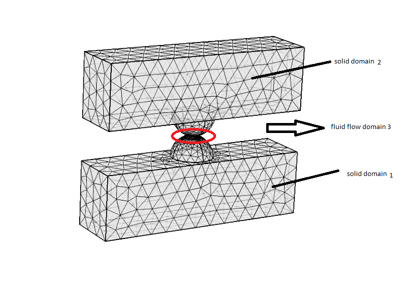

I encountered a problem when I models fluid flow through conduit surrounded by solids at two sides. The models involves laminar flow module and structure module. According to the description of reference manual, When the contact features are included in structure mechanics, the "form assembly" in geometry is recommended. So I choose the "form assembly" box. However, when I imposed no-slip BC at the interface between solid and liquid domains, and run it, the error occurs.

Form the attached image, we can see that domain 2 is solid zone, no fluid, whereas the error didn't detect fluid velocity in the soild zone. It seems weird. I try many times to resolve it but failed.
So I am wondering whether the "form assembly" in my model is the criminal. But considering the contact feature in my model (circled region in red line), I am not sure for it.

Thanks for your prompt reply. After carefully check my model, I think my model applies to the case that it has a contact pair between two solid domains and two common boundaries between each solid domain and the only liquid domain. In this case, the contact pair and common boundary co-exist concurrently. So It make me confused about the setting for "Union" or "Assembly".
I intended to set the continuity state (extensive quantities and their gradients, i.e. heat flux, heat, etc) across the common boundaries between solid domain and the only liquid domain. For the contact pair, I hope to get compression and friction or slip in next step. In this sense, the setting of this case is complicated. By the way, my consideration is based on this support description: www.comsol.com/support/knowledgebase/1216/

First of all you have a complex 3 physics case with many couplings, then you two half sphere that touches each other at a point, for a 3D physics with *contact*, you have set-up a system defined with a singularity at the contact point.
