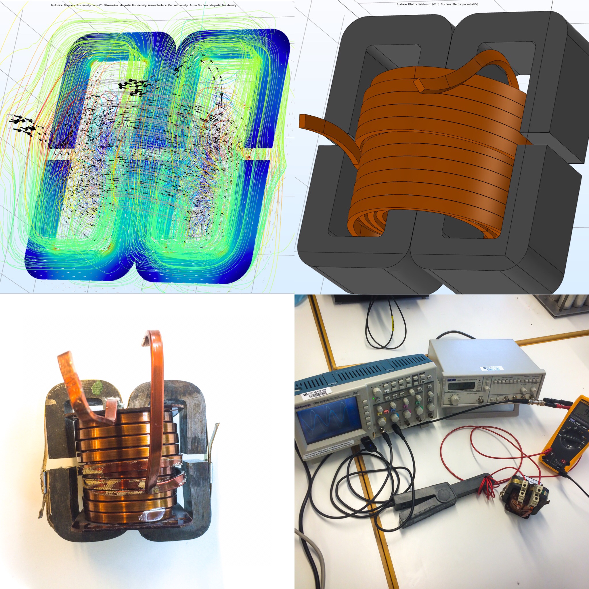

I have created a coil and am running it at different turn number and frequencies to verify that the model is outputting correct inductance.
Using "magnetic and electric fields" (mef) and a frequency domain study, I am running the following parametric sweeps:
N=5,10,15 turns
f = 10, 50, 100, 500 Hz
However, after running N=5 through all frequencies, N=10 does not converge at f=500 Hz.
Does anyone have any tips on how to tweek the solver?
I am currently running FGMRES and it "slows down" between a convergence of 2-5 while SSOR iterates to 1 000 000 and it gives up.

Greetings, Ivar. It is an honor to have you in my thread :)
My fault is almost bordering idiotic, but I forgot to disable the study "coil geometry analysis" after disabling the multiturn coil.
After that it worked out nicely, and I got good results:
Physical inductor: measured by impedance method at 128 uH
Modelled replikaka in comsol: 126.55 uH
I hope it's not pure dumb luck
