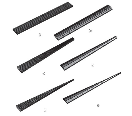

Energy Harvester with Different Geometries and Cross Sections
hello sir
with all due respect i need some help regarding cross section in comsol multiphysics. i got some problem related to different geometries and cross sections . i tried harder to create trepezoidal form but i failed and didn't got as i want to get . so help to make through this and i have jpg of cross sections .
it's very important plz help me asap
thnx

Hello Sahrukh,
You can create such geometries by using the lofting capability found in the Design Module:
www.comsol.com/design-module
Hello Sahrukh, You can create such geometries by using the lofting capability found in the Design Module: https://www.comsol.com/design-module Best regards, Jeff

sir
thank u for your response can u plz make any one of them geomatry so that i can learn from your model.
sir thank u for your response can u plz make any one of them geomatry so that i can learn from your model.

If you do not have a license for the Design Module, please contact your COMSOL representative to request an electronic copy of its documentation. It is quite detailed and includes examples.
If you do not have a license for the Design Module, please contact your COMSOL representative to request an electronic copy of its documentation. It is quite detailed and includes examples. Best regards, Jeff
